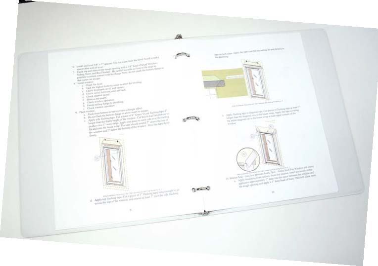

The best way to address this problem, we eventually decided, was to create our own company “best practice” manual — a set of procedures for installing all the parts of a home, from doors and windows to roofing and siding, that everyone would follow and that could be revised as needed to keep up with the latest thinking. The manual would also outline critical business procedures, like the steps involved in starting or finishing a job.
We had been talking about this project for some time when JLC published its Field Guide to Residential Construction. It was just the motivation we needed. Although I liked JLC’s systematic approach, some of the advice didn’t fit how we build in our climate, using our particular building materials and according to our local code. So we decided to use the Field Guide as the starting point for developing our own guidelines.
We began the project by tackling the two areas that had caused us problems or led to callbacks: window installation and roof flashing. A year later we had a half-dozen sections completed; within months we were reaping tangible benefits. We call our manual The Criner Way: A Manual of Best Practice for Criner Construction Co. It’s a work in progress, a three-ring binder that we add to a section at a time.

Writing a manual is like any project — it needs a project manager. I gave that responsibility to our designer, Ben Rooker, because he’s comfortable in both the field and the office, and with research and writing. His general approach is to write a draft, submit it to our field crews for review, and then rewrite it according to their feedback.
For each section, he starts by gathering input from our lead carpenters, the JLC Field Guide, Web sites, trade journals, and manufacturers’ literature. For example, he used Pella’s installation instructions as the basis for the window-installation section, but supplemented it with JLC’s advice to place a bevel on the sill of the rough opening. Once the first draft is complete, he and I meet with our production manager, carpenters, and helpers. We review the draft procedure line by line, then open the floor for discussion. Some of these exchanges can get quite lively, for the simple reason that there is little agreement in the industry about best practice.
Take door sills, for instance. The JLC Field Guide might call for a metal pan or Z-flashing, while a trade-journal article may advise a one-piece rubber flashing. One door manufacturer might call for a two-piece rubber flashing, whereas another may not specify anything at all. We have to decide which combination of methods gives us the best result without voiding the warranty. These issues can take time to iron out.
Show and Tell
They can also require a bit of show and tell. That was the case with window flashing, which in addition to shedding water must prevent wicking, capillary suction, and vapor pressure. Because every lead carpenter seemed to have a different idea about how best to flash a window, we decided to mock up a small wall section and install a window that had been lying around the shop. We spent a couple of hours trying different flashing methods before settling on one that everyone agreed to use. Giving all of our carpenters a hand in the outcome creates a great sense of buy-in.
When we first started the manual, we had special meetings to review each section. These became difficult to schedule, so now we include a 15-minute best-practice discussion at our weekly shop meeting. We hold it at the beginning of the session, when there’s plenty of energy; but we stick to the time limit to keep the overall meeting from running too long. Developing standard procedures using this approach takes a bit longer, but the discipline of short weekly discussions has made best practice a part of our company’s DNA.
Ben takes notes at these meetings, and when we do come to agreement on a procedure, he writes it up to reflect the company’s best judgment as a whole. Then we distribute final copies to all the field employees, who keep them in their binders. Every employee gets a manual.
