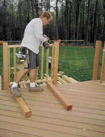

For example, the posts in our standard railing system are visibly bolted to the exposed face of the band joist, but we also offer an optional post detail that embeds their bases in the deck surface (see Figure 1). The square-foot cost of our basic deck is based on the externally mounted posts. If the customer wants to upgrade to the embedded posts, we charge an additional $20 per linear foot of railing. If the customer selects our 6×6 cedar post option, which includes a decorative finial cap, chamfered corners, and a base molding, we charge $180 per post.
Figure 1.In an optional upgrade to the standard bolt-on post system, the deck boards are cut flush with the girder, and 2×4 cleats are nailed between the posts (bottom left). A 2×10 finish band joist is then fastened to the faces of the posts, followed by a 2×8 laid flat and notched around the posts (top). The embedded posts have a strong visual connection with the deck, while the overhang at the band joist creates an attractive shadow line (bottom right).
We also offer a broad range of railing options, from the upscale Chippendale style to the relatively modest Madison Colonial version (Figure 2). The latter isn’t much more difficult to assemble than the base-priced square-baluster-and-rail system, but it provides a higher profit opportunity. If your average markup is, say, 35%, adding such higher-priced options can easily bump it to 50% or more.
Figure 2.The author’s base-priced deck uses a square-baluster-and-rail system, but a broad range of additional styles are available for a variable upcharge, which is calculated by the linear foot. The ornate Chippendale railing (top) is a premium-priced option, while the Madison Colonial (bottom) is a more modest upgrade.
