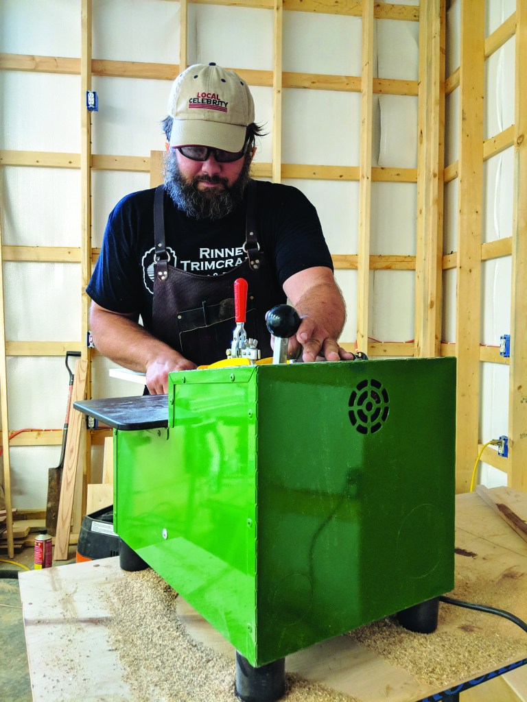

When my TSM-12 Benchtop Pocket-Hole Cutter arrived, it was shipped so well that it took a solid 10 minutes to cut away all the packing foam, shrink wrap, and tape from the individual parts. I mention this because I have received tools so poorly packaged for shipping that the mess of damaged parts that arrived was inevitable from the moment they were put in the box.
As I was putting the machine together, I admired how heavily built everything is. Even the U-bolt that holds the cutting router in place was overly large, which I like. The instructions, warranty info, and other miscellaneous literature came in a three-ring-binder folder, which seemed more personal than the typical mass-produced instructions I’m used to seeing.
A Different Way To Make Pocket Holes
The Castle pocket-hole cutter uses a unique setup to cut its pocket holes, using two Bosch routers. One cuts the pocket and one drills the pilot hole. You simply push the lever forward to cut the pocket and pull it back to drill the pilot hole. The whole process takes just a few seconds with repeatability that you can’t get with a manual jig.
What I like best about this setup is, should a router ever fail, I can easily go to a big box and get a replacement that day. That, to me, is peace of mind I wouldn’t get from a unit with a proprietary motor. In fact, given today’s throwaway culture, I’d almost bet it would be cheaper to buy a new machine than to replace a motor on one of the other commercially available units.
If you’re only used to the Kreg style of pocket holes, you’ll find another feature to love about the Castle: The holes are cut at an angle less than half (6 degrees rather than 15 degrees) that of the Kreg. With that change, you not only are more in plane with your mating piece—lowering the chance of the two slipping apart when you’re screwing them together—but you also leave more wood fiber surrounding the screw. This translates to a stronger joint. Castle offers several styles of precut plugs for these holes, including an easily removable plastic plug that is actually quite attractive.
Dust Collection
As shipped, the TSM-12 isn’t ready for dust collection. The bottom is wide open, allowing access to the internals for setup. However—add a point in the cool column—the company sends a template to cut a base from plywood if you desire to do so. Once you have the bottom in place, there are two knockouts on the back of the machine for connecting either a shop vacuum or a 4-inch collection hose.
I have been pleased with my TSM-12 since it arrived. It increases my efficiency, which in turn increases my bottom line. Given how well it’s built, I also enjoy the confidence of knowing I will get a lifetime of service from it, and that isn’t something I can say about every tool I own.
