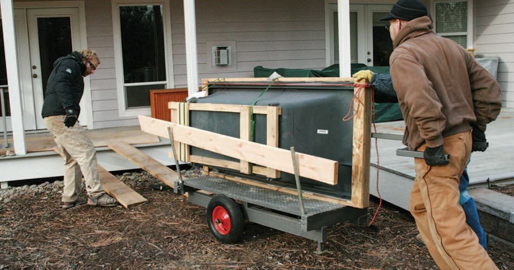

To help hold materials that don’t stack nicely — like old studs or siding riddled with nails — I welded brackets to the frame to support removable 1-inch-diameter poles.

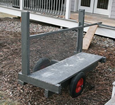

We have limited access on a lot of our jobs; it’s not unusual for us to have to park out on the street and haul tools and materials back and forth between our trucks and the work area. After searching in vain for some sort of material hauler with large wheels that would navigate turf as well as dirt, I finally decided to build my own.

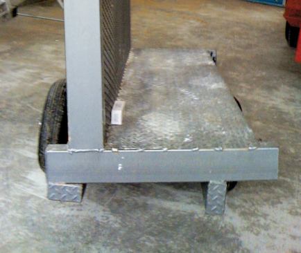

The design was determined in part by the scrap metal that was available in the recycle area of my local salvage yard. I used several pieces of 2-inch by 4-inch steel tubing with 1/16-inch-thick walls to make the cart’s frame. The 26-inch-long crosspieces are supported by 60-inch-long stringers, one of which I positioned on the flat when I welded the pieces together, so that the bed tilts slightly (see slideshow). This helps keep lumber tight against the upright arms when the cart bounces over bumps.
The cart rides on a pair of wheelbarrow wheels fastened to a 5/8-inch-diameter axle welded to the frame. It’s 35 inches wide, so it fits through a typical exterior door, and I sized the 32-inch-long uprights so it would fit under the cap of my pickup after I remove the wheels.

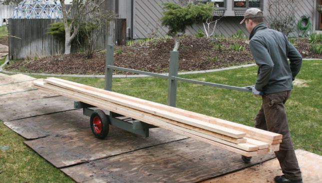

One of the cart’s key features is a long extension handle that I made out of 1 1/4-inch-square tube; it slides into 1-1/2-inch-square receiver tube welded to the uprights 20 inches above the bed. The handle can be positioned so that the operator is directly behind the cart, or it can be flipped over so that we can walk off to the side when we haul longer items like 12-foot drywall or 16-foot 2x4s.
I originally built the cart with a simple plywood bed but soon replaced the plywood with a 17-1/2-inch by 60-inch by 1/8-inch-thick piece of diamond plate welded to the frame. Even though the metal deck and the stretch metal between the vertical uprights make the cart heavier, smaller items like tools or garbage cans are much less likely to fall off. To help hold materials that don’t stack nicely – like old studs or siding riddled with nails – I welded brackets to the frame to support removable 1-inch-diameter poles. At 120 pounds, the cart can be loaded into a truck by one man and can easily handle 300- to 400-pound loads, about as much as one man can push on soft ground. Altogether it took eight to 10 hours of labor and $200 in materials to build this cart, but it’s become one of our most valuable tools.
