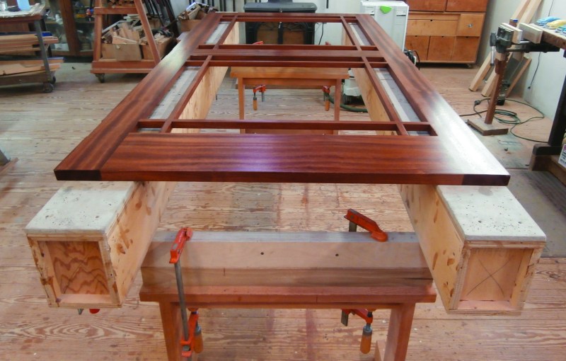

Each box beam measures 5 inches wide by 8 inches tall and 8 feet long. All the rips for two beams (one set) come from one sheet of 3/4-inch, shop-grade plywood. Making the top 6 inches wide makes a slightly better work surface, but requires one extra rip from another sheet of plywood. I cap the top with 1/2-inch Homasote to make a finish height of 8 1/2 inches. It is important to make any additional beam sets the exact same height for large build platforms, like the one I used for routing a 60-inch radius with a trammel router jig (see “Curved Paneling for a Circular Room,” Aug/16). The 6 1/2-inch rips for the sides of the beams must be straight, parallel, and perfectly matched.
Each beam has five interior squaring blocks that are cut from scrap material. Thickness is not so important for these, but they must be cut precisely to ensure the beams run straight and square. A few biscuit joints help with assembly of the beams and add strength. Glue and screw the beams together, clamping them tight.
To support the beams, I make pairs of trestle-type sawhorses out of vertical grain fir (I select clear, 36-inch lengths out of 2×10 rafter stock from my local lumberyard). The horses measure 28 inches high with a 2×2 straightedge on the top bar that can be removed and re-milled as it wears out.

Large fixed tables are wasted space in any shop. If I need a large table for layout, I clear space and drop a sheet of plywood on the beams. A workbench is made by screwing a half sheet of plywood to the beams. All Domino work and all sanding happens on the beams. I cut 1-inch-wide strips of Homasote and screw them to the beams as stop cleats for holding pieces for sanding. This can be done hundreds of times with no damage to the beams.
I also lay out and biscuit all my kitchen and built-in storage boxes on the beams. Basic cabinets can be glued up and clamped together on the beams. A set of two perfectly matched beams is essential for clamping up a door that is flat and has no twist. If I need a tail vise (which I use for holding doors when planing the edges and mortising hinges), I double the plywood thickness on one end and overhang it 8 inches to accept the vise (see photo below). Two beams and a few bar clamps make an excellent press for gluing up thick stock from thinner boards (for example, sometimes my door stock is 1 1/2-inch-thick stock made from 3/4-inch boards).
