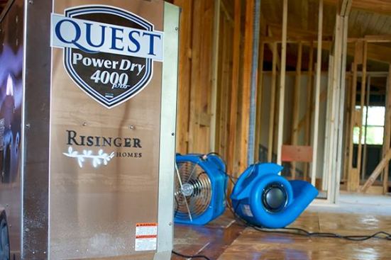

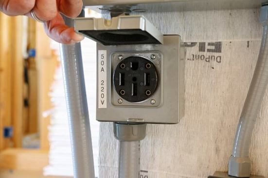

If you build or remodel homes for a living you’ve definitely encountered times when the crews didn’t have enough power. This is especially true when you condition your houses during construction. I’m a big fan of Quest Construction Dehumidifiers, Air Conditioners, and Electric Heaters (the heaters run at either 30 or 50 Amps!). Couple that with a 220V cabinet saw for my finish carpentry crew, several miter saws, two compressors, and a half dozen makita chargers and you can quickly max out a small temp power service!

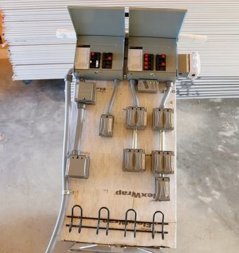

I thought I’d share how we bring a portable power panel to our jobs to get everyone connected. First, here’s the video overview.
Here’s the parts list you’ll need to make one for yourself. It’s going to run about $1000-1200-ish for the parts but this power panel should provide many years of use. Tim Hill my Project Manager made this parts list for this particular panel box:
Fittings for conduit to panels
  • 110′ 4 ga. 3 conductor with ground aluminum “service entrance cable”
  • Lastly, you’ll want a 45 degree position hand truck to make it manageable getting to/from the job site and to set it up onsite.
