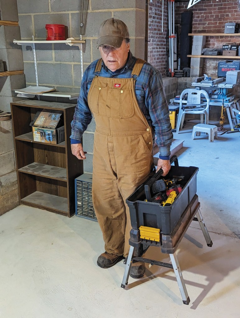

DeWalt’s DWST25090 storage step stool consists of a large tool tote and separate step stool that can be used separately, or clamped together for transport. Here, the author uses the stool as a small work platform...
...while he uses the tote to store his cordless tools.

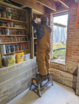

The step stool is about 17 inches high with a 10-by-23-inch top. Rated to support 300 pounds, it’s stout and stable along with being handy, especially for interior work. If I step up on it, my eyes are just above the top of a standard 6-foot 8-inch door, and I can easily reach an 8-foot ceiling. In addition to standing on the step stool, I often use it as a small work platform.
The toolbox can be quickly and securely attached to the top of the step stool via two integral clamps mounted to the ends of the stool. With the toolbox thus mounted, I can carry both the fully loaded toolbox and the stool with one hand. Then, if I need to use the stool, I can unclamp the toolbox in a matter of seconds. Alternatively, the legs can be folded up and the step stool clamped to the top of the toolbox to become a lid.
The stool has a 300-pound load capacity, and enables the author to reach an 8-foot ceiling.
In some circumstances, I leave the toolbox clamped to the stool. Doing this holds the toolbox up, and I can grab the tool I need at a convenient height. Alternatively—here’s where being able to fold the handle down inside the box and out of the way pays off—I can put a piece of plywood over the top of the toolbox and have a nice 1-by-2-foot shelf at a convenient 25-inch height. Going even further, I’ve considered getting a second DeWalt storage step stool. That way, I could set up the pair about 4 feet apart and lay a piece of plywood across them to make a 2-by-4-foot worktable 25 inches high.
