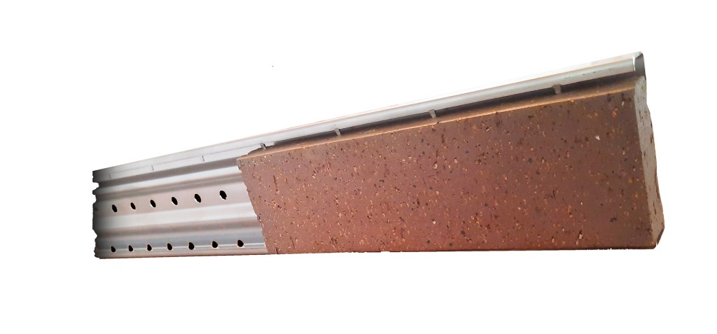

Durus Standard brick-façade trays can secure bricks from a variety of manufacturers, including Belden, Endicott, and Metro. Teeth hold the bricks in place, weepholes in the 20-gauge 304B stainless steel trays let moisture drain out, and a 2-inch air space between the trays and the house wall allows for bulk drainage and airflow to help the wall assembly dry. Stiffener ribs and a uniform base add structural strength and guide horizontal and vertical alignment. Spacing between trays can be adjusted to account for rough openings. desanapartners.com
