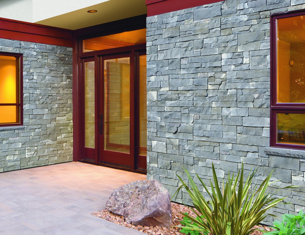

Certainteed recently introduced Stonefacade, a concrete masonry veneer that doesn’t require mortar; instead, panels attach over the wall’s weather barrier with screws through a stainless clip. This installation system creates a 3/8-inch air space and weep channels behind the stone that promise to alleviate water-intrusion problems that have plagued conventional “faux stone” products when poorly installed. The ledgestone-look panels are 8 inches high in 10-, 14- and 24-inch widths. Pricing is not yet available. certainteed.com
