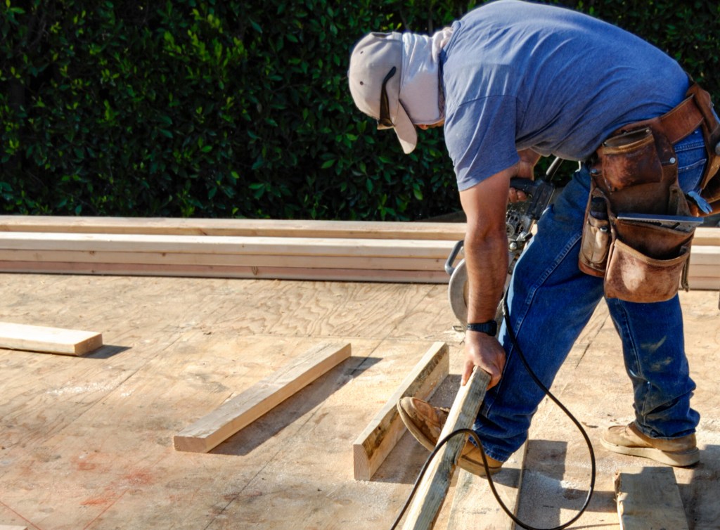

They measured boards with a tape and used a framing hatchet—the same ones they always kept on their belts in lieu of a hammer—to make their layout marks. None of their saws had blade guards, and they ran a pair of ancient Hitachi guns like they were automatic weapons. I was always at least two paces behind them on any given task. (I kept my guard on and used a pencil; what can I say?) And I was literally behind Diego when he sliced the end of his boot off, along with all the toes on that foot.
Diego had been cutting blocking with the board propped up on his foot. He would plunge the spinning, unguarded blade straight down for each cut, moving with minimal effort and maximum speed. Practiced as he was at this maneuver—he must have done this many thousands of times—it seemed inevitable something like this would eventually happen.
