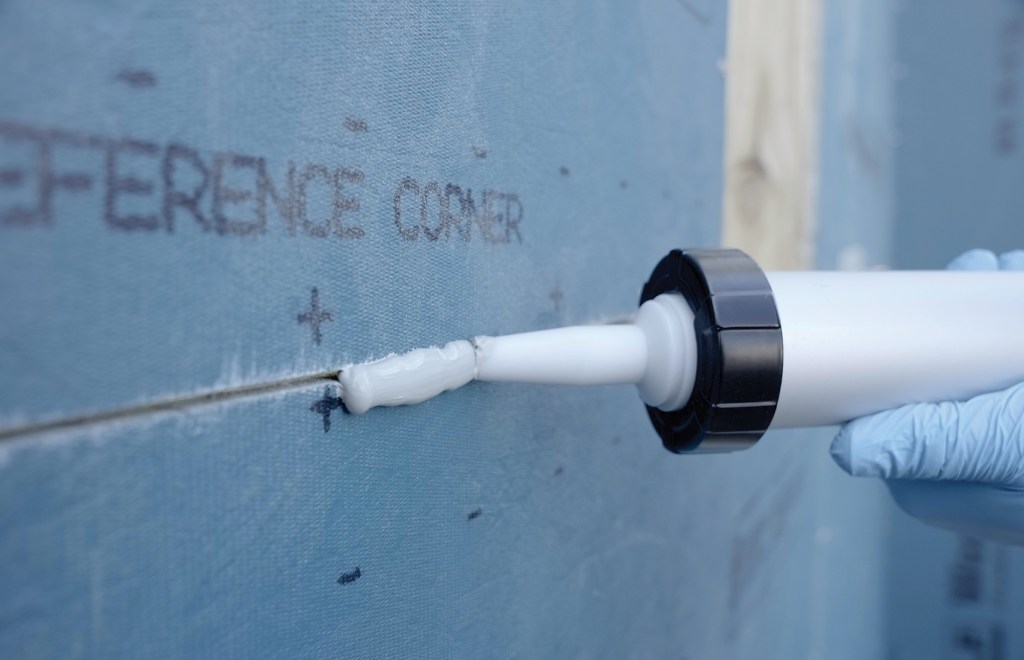

LP WeatherLogic Seam & Flashing Sealant is a liquid-applied flashing material certified to AAMA 714-19 and is the only liquid-applied sealant approved to seal the joints between LP WeatherLogic panels. The sealant can also be used to flash window and door openings, material transitions, and penetrations of any shape (gaps wider than 1/8 inch should be filled with backer rod). Surfaces must be clean and dry before application. The VOC-compliant sealant has a 10- to 15-minute tooling time and a 110-minute surface tack time, and can fully cure in 24 hours, depending on conditions. lpcorp.com
