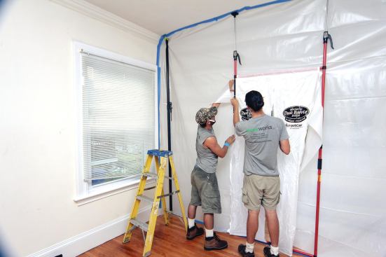

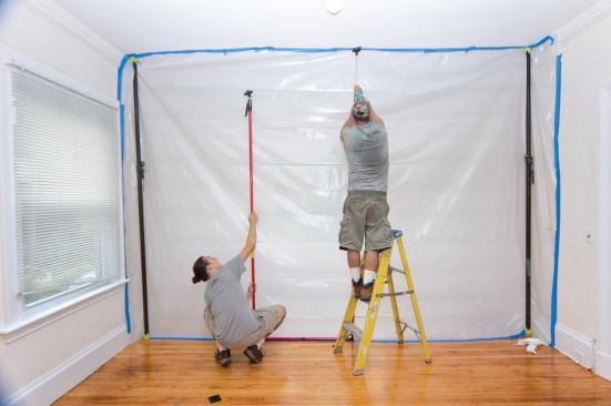

Setting up the door is easy (videos on the manufacturer’s website clearly describe the process). First, we put up our main plastic dust wall, supporting it with old photographic background stands. Next, we set up a pair of FastCap’s Third Hand steel poles, plumbing them in both directions as if framing up a door. These supports are included in the $200 door-system kit, but a $100 version is available if you don’t need them.

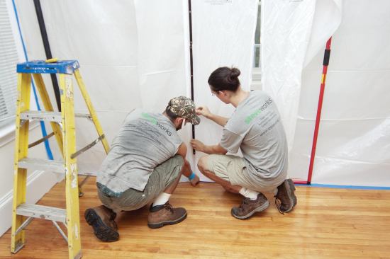

The door’s threshold and header bars are designed to clip to the uprights; when the header bar is at the right height, the dust door flaps should reach the center of the lower bar. Once the door is in place, a T-shaped cut needs to be made in the barrier wall behind the door, so that about 3- to 4-inch-wide flaps of plastic remain inside the steel uprights. These plastic flaps get wrapped around the upright poles, and are held in place with long flexible strip magnets supplied with the door.

The regular strip magnets that are used to hold the door flaps to the supports and the plastic from the dust wall to the upper header bar work fine, though — they’re plenty “sticky.” For storage, they can be left attached to the bars or stacked together.

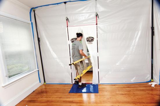

Once the door has been tweaked to hang correctly, it does a pretty good job of containing dust, especially when we avoid using dust-generating tools near the opening. To improve enclosure performance, we usually set up a window fan, which creates negative pressure within the containment area and helps draw the door flaps closed. We also put down a tack mat (877/800-3723, certifiedrenovatorstore.com) at the entrance, which cleans the bottom of our shoes and prevents dust from getting tracked around.
