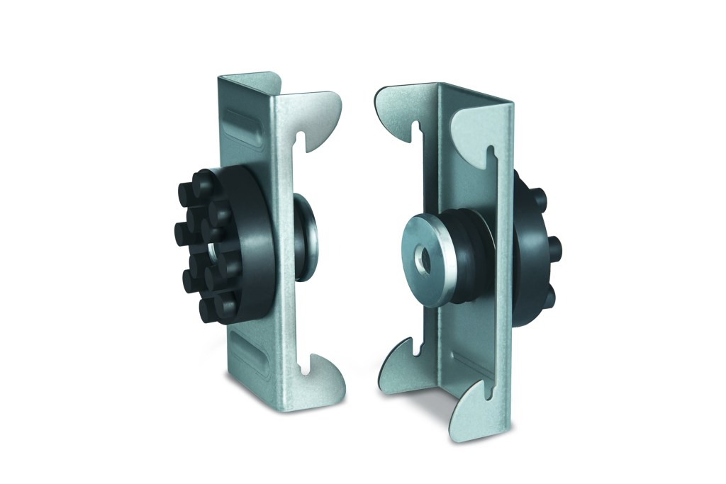

Sound-Dampening Connector
ClarkDietrich’s Sound Clip (CDSC) fastens gypsum wallboard to framing members in various wall and floor-ceiling assemblies, while providing acoustical separation. When used in conjunction with 18mil (25 ga.) 7/8-inch-deep drywall furring channel, the clip functions as a decoupler, permitting the attachment of gypsum board to the framing members without any contact between the two components. According to the manufacturer, the system will reduce the amount of airborne sound filtering from room to room. Contact a local distributor for pricing. clarkdietrich.com
