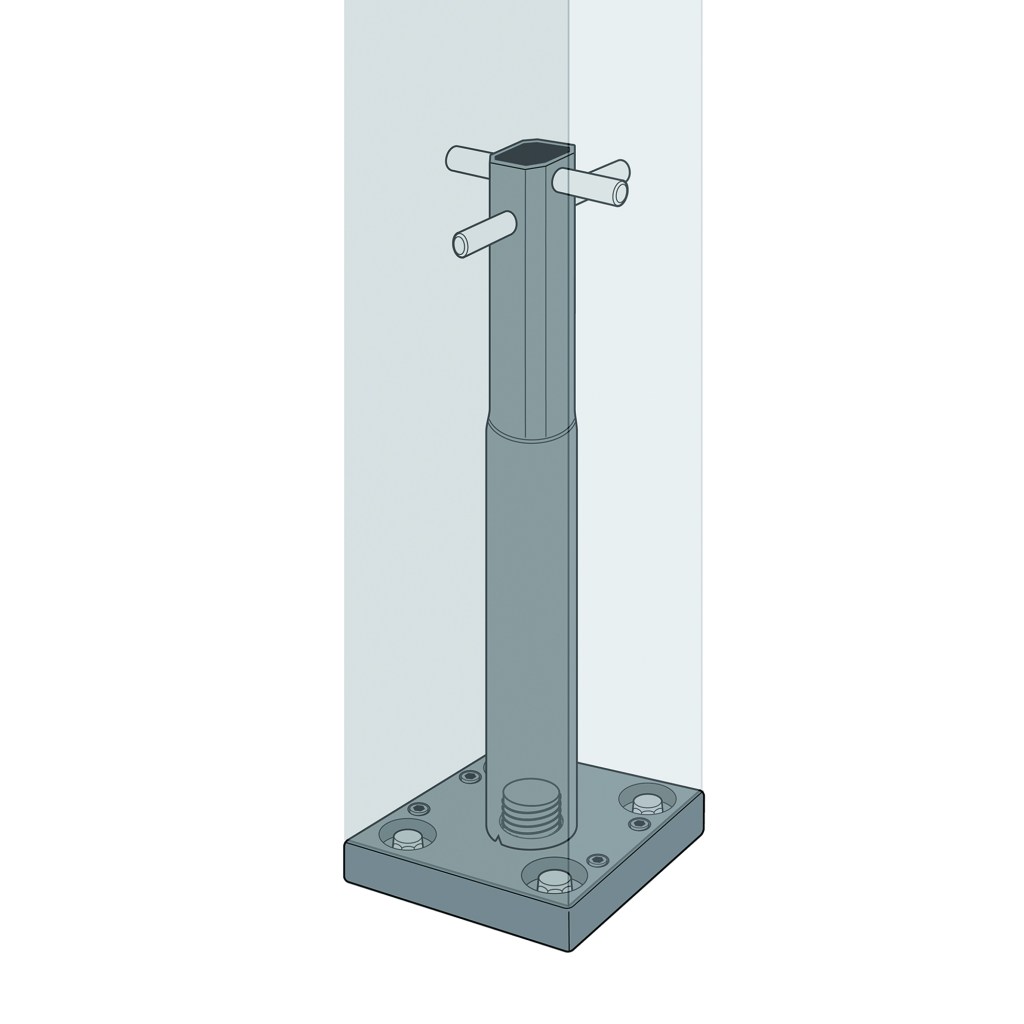

Titan’s Evolution structural post anchors provide a surface-mounting solution for wooden columns. Each kit consists of a 1/2-inch-thick HDG steel base plate with a black powder-coated finish, a 1 1/4-inch-diameter-by-11-inch-long threaded steel tube, and a 1 3/4-inch-long threaded stud that joins the tube and the base plate together. The base plates, which are available for 4×4 and 6×6 posts, are fastened to concrete and stone surfaces with 3/8-inch-diameter-by-3-inch wedge bolts. The holes can be plugged to conceal fasteners. Cost for the kits starts at $60. titanbuildingproducts.com
