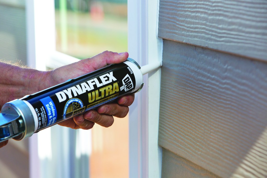

Rain Resistance Within One Hour
DAP’s new Dynaflex Ultra Advanced Exterior Sealant uses Weather Max technology to provide UV protection and dirt and water resistance. The sealant has a lifetime mold-, mildew-, and algae-resistance guarantee, is paint- and rain-ready one hour after application, and resists fading, bubbling, yellowing, or cracking, according to the company. It’s available in white, clear, beige, clay, iron gray, and dark bronze. dap.com

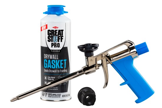

Dow
What’s in a Name?
Dow’s Great Stuff Pro is a flexible foam sealant designed to withstand the scraping and rubbing of drywall installation. It is a water-based, low-VOC sealant that is flexible when cured. It can be applied to the face of framing lumber around all rough openings and around the top plate and bottom plate. It cures in 2 to 24 hours, depending on humidity. dowbuildingsolutions.com

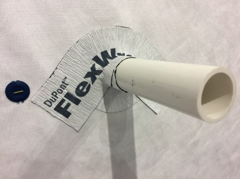

DuPont
Easy Peasy
DuPont’s FlexWrap EZ is an adhesive tape that can be used around wires, plumbing pipes, HVAC components, and more. It is composed of 100% butyl adhesive and can withstand up to 270 days of UV exposure, according to DuPont. The rolls are 2 ¾ inches wide and 15 feet long. DuPont says one roll will cover an average size house. dupont.com
