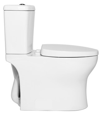

Niagara's Phantom toilet
Niagara

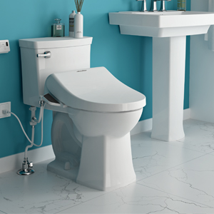

American Standard’s new Advanced Clean SpaLet bidet seat lets users set their own pressure, temperature, and seat-heating preferences to customize their experience.
American Standard
Bidets aren’t all that common in American households, but the benefits of that little spray are many. Some bidet seats, including American Standard’s SpaLet seat, allow users to customize options like spray intensity and temperature from a side-mounted control panel or a remote.

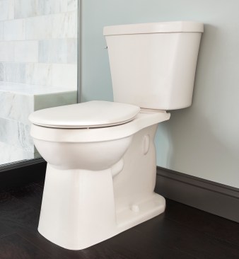

Gerber’s new Avalanche Elite toilet is a one-piece fixture with a semi-concealed trapway for a streamlined look. As its base is a bit larger than one on a standard toilet model, it more easily covers up unsightly floor damage during remodels. Gerber says the flushing system has 50% more line carry than the national standard. gerberonline.com

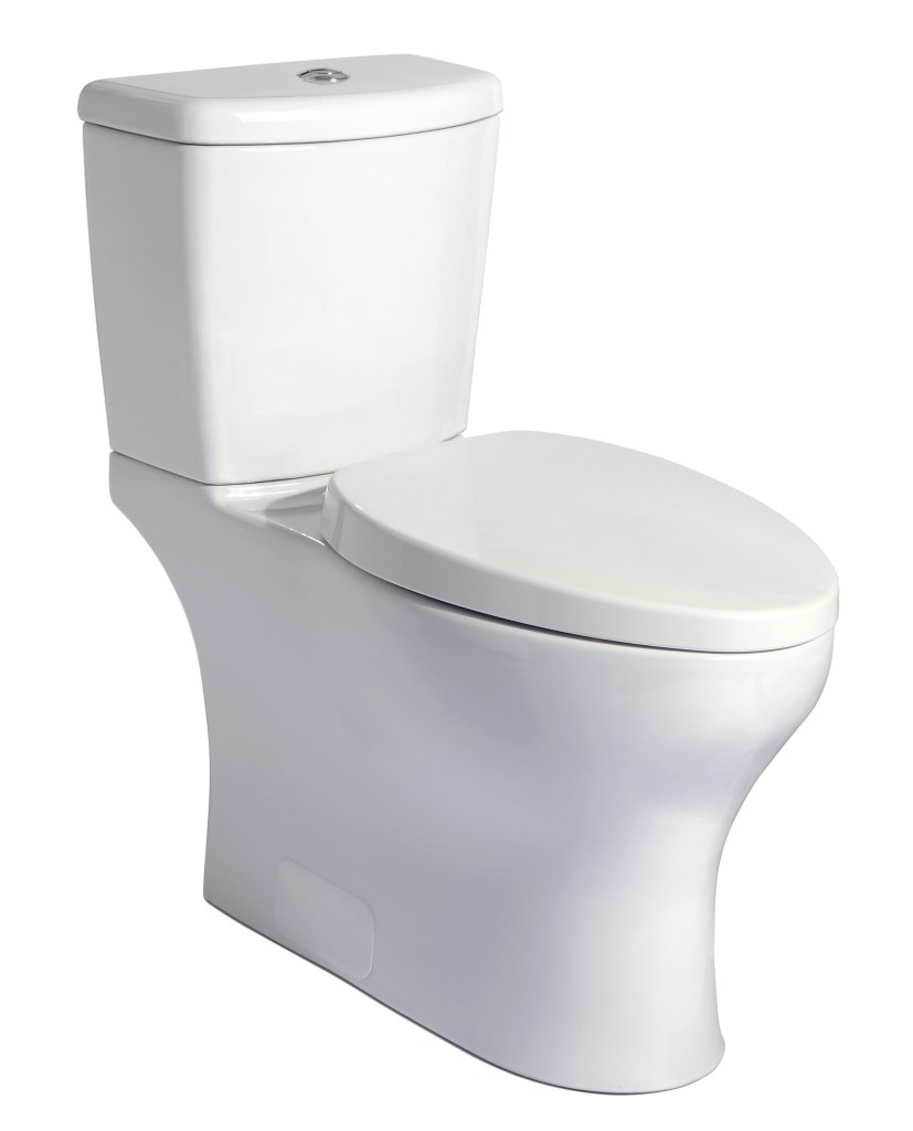

Niagara has released its Phantom toilet. The two-piece toilet uses the company’s Stealth Technology, which quiets the toilet’s flush without sacrificing power. The toilet is WaterSense certified, using 0.8 gallon per flush. The company says it is also Maximum Performance (MaP) premium rated and certified by the American Society of Mechanical Engineers. niagaracorp.com

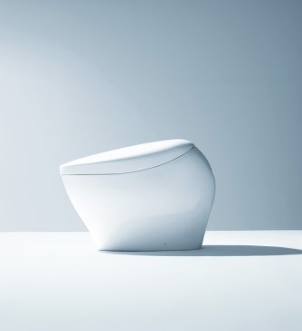

TOTO’s new Neorest NX Intelligent Toilets feature an ergonomic seat. The NX 1 model includes TOTO’s eWater+ technology, which mists the bowl with electrolyzed water to help keep the bowl clean longer. The NX 2 toilet has the company’s Actilight advanced cleansing technology, which mists the bowl with plain water to reduce waste’s adherence. The toilets also feature auto open/close and auto flush. totousa.com
