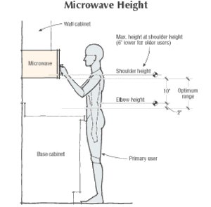

Even if there's countertop space to spare, standard countertop height isn't necessarily the best height for a microwave. Ergonomic studies show that the most convenient height for placing items in and removing them from a microwave is somewhere between 2 inches below and 10 inches above the elbow of the primary user (Figure 2).
Figure 2.For safety, as well as ease of use, the microwave should be placed no higher than the shoulder height of the primary user. Six inches below shoulder height is better for older users. The most convenient height, according to ergonomic studies, is between 2 inches below and 10 inches above the user's elbow height.
If that user is about 5-foot-6, countertop height is probably fine, keeping in mind that the interior of the oven will be a couple of inches higher than the surface it's placed on.
Recognized safety criteria state that the oven shelf should be located no higher than the principal user's shoulder height and preferably 6 inches lower than shoulder height. In any case, the cook should be able to look into the oven and look down upon the food item.
In fact, the average user will have few complaints with a microwave installed in the bottom line of wall cabinets, with its interior shelf or rack about 54 inches above the finished floor.
