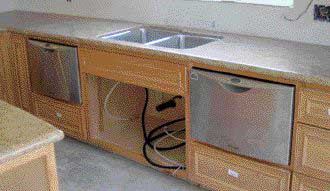

Once we determined our finished countertop height -- we were shooting for 33 inches above the floor -- we knew we'd be building custom, 32 1/4-inch-high base cabinets (allowing for a 3/4-inch-thick stone countertop). Not a stretch -- no pun intended -- until we took standard appliance dimensions into account. Our dishwasher options were limited, as far as I know, to one. Instead of a standard unit, we used two Fisher & Paykel single-drawer dishwashers, one on either side of the sink (see Figure 1), a nearly ideal solution, notwithstanding the $700 cost per unit.
Figure 1.A pair of single-drawer Fisher & Paykel dishwasher units solve the problem of fitting a standard unit beneath a countertop of substandard height.
