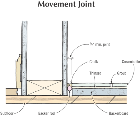

Packing grout into the wall line at the perimeter of the room is a leading cause on the failure list. A minimum 1/4-inch joint along the entire perimeter of the installation must remain free of grout, backerboard, and thinset (see illustration below). Floor tiles must be allowed to move. At the edge of a room, leave a gap between the backerboard and tile and the wall. If there is no baseboard, finish the gap with backer rod and caulk. Don't use grout; it will crack.
Where there is no baseboard, use backer rod and caulk to fill the gap at the perimeter. If an installation is regularly exposed to sunlight, you must place movement joints at intervals no greater than 12 feet. Complete recommendations are contained in the TCA Handbook under detail EF171.
