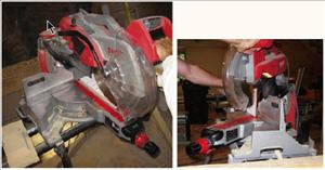

Few sliding miter saws can match the capacity of the 6955-20. With the material on the flat, the saw can crosscut up to 13 1/2 inches wide at 90 degrees, and 9 1/2 inches wide at 45 degrees. With the material on edge against the fence, it can cut more than 6 1/2 inches high — but only very thin material (less than 7/16 inch thick).
However, it can cut 6-inch baseboard on edge in any thickness.
Accuracy. The slide mechanism and table operate smoothly, and the cutting action is tight and stable. Miter and bevel cuts are both very accurate. I made a compound 45-by-45-degree cut in 1×10 poplar, checked it with a digital protractor (Bosch DWM40L), and found the angles to be within 1/10 degree of what they were supposed to be.
The 6955-20 has excellent capacity. It can crosscut up to 13 1/2 inches wide (left) and 6 1/2 inches thick (right). One of the few problems I had with the Milwaukee happened when I was cutting pieces wider than the blade. If the trigger is released at the end of the cut while the blade is in contact with the work, the braking action torques the blade enough to leave slight teeth marks on the edge of the piece. I got around this by sliding the piece away from the blade before releasing the trigger.

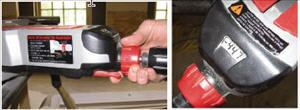

Digital readout. Next to the miter lock knob is a digital readout. Used with the detent override and the fine adjustment ring, this feature is of immeasurable value. You can make extremely fine adjustments to the miter setting — 1/10 degree per quarter-turn of the knob — by pulling the detent lever and pushing the adjustment ring. The readout tells you exactly what the angle is, so that you can transfer angles from an electronic angle finder and easily repeat odd angle cuts.
Another handy aspect of the readout is that it allows you to read the angle when wide material covers the miter scale.

Pressing a detent override and rotating a fine adjustment ring allows the user to dial in miters to within 1/10 degree (left). The setting is displayed on a digital readout (right) that makes it easy to repeat odd angle cuts. Final Notes
