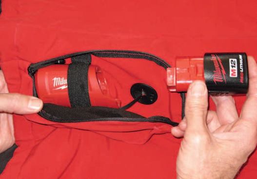

Sold as part of the company’s 12-volt lithium-ion power-tool line, the jacket has heating elements sewn into its chest and back. They’re powered by a battery that sits in a pocket at the jacket’s waist. At first I worried that this sizeable lump would be annoying, but it rode comfortably above my toolbelt and remained well clear of my suspender harness. After a while I forgot it was there.

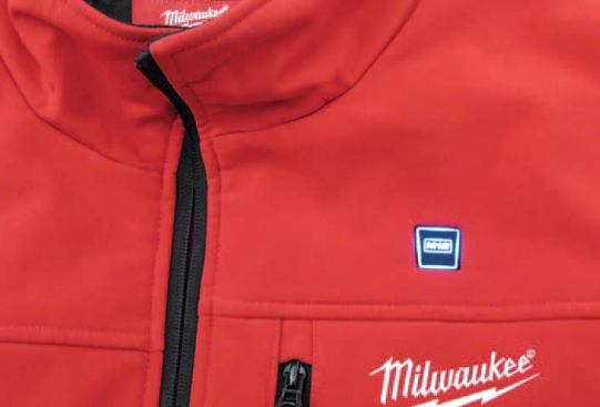

A push button sewn into the jacket’s lapel switches the heat on and off and selects the temperature – high, medium, or low.
