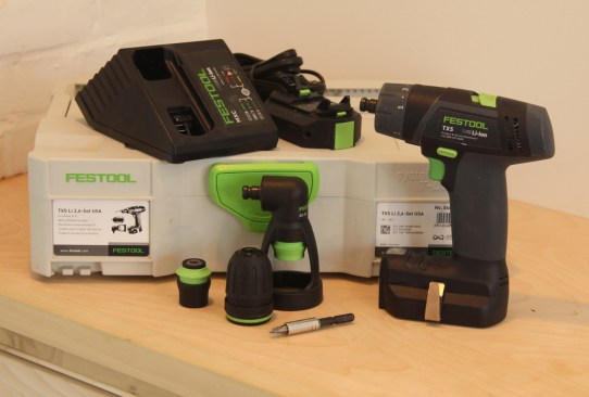

The TXS Set comes with a charger, (2) 10.8 V batteries, 3/8" keyless chuck, centrotec chuck, BH60 Bit Holder and Systainer case. The TXS Plus comes with the FastFix right angle chuck as well.

Cost: TXS Plus (drill, two batteries, charger, Centrotec chuck, keyless chuck, bit, bit holder, Systainer case), $235; TXS Set (TXS Plus kit and right-angle chuck), $285

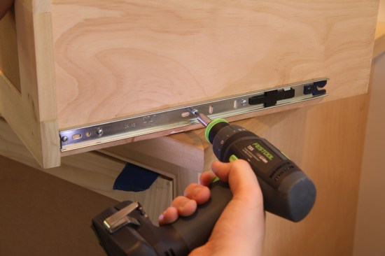

I used it most often for pocket-hole joinery, installing cabinet and door hinges and drawer glides, and for cabinet installations. It set 2 1/2-inch screws through 3/4-inch plywood into studs without effort. The drill was great for setting electrical outlets and switches, as well. The variable-speed trigger has a soft actuation, but was still firm enough to maintain even slower speeds without losing the right “touch.” The 3/8-inch keyless chuck accepts 1/32-inch to 3/8-inch drill bits and worked as expected on poplar, maple, and oak stock.

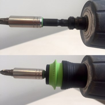

Of the three interchangeable heads, the Centrotec chuck is the one users will probably use most often. It’s a quick-change system that accepts only Festool’s proprietary bits. Removing the Centrotec chuck offers added versatility; the drill accepts all bits or bit holders. The Centrotec chuck design does lend itself to smoother driving of screws because it holds the bit in two places rather than one, and it holds the bit at a higher point on the shaft, so there is less maneuverability when it spins. I compared this with other drills that I have and while it wasn’t a scientific test, I did notice a difference in the play when a bit spun in the Centrotec chuck vs. other drivers in my shop.
The Centrotec quick-change chuck holds Festool’s proprietary bits and makes for a smoother rotation of the bit by gripping it in two places— the bottom and the middle of the shaft.
