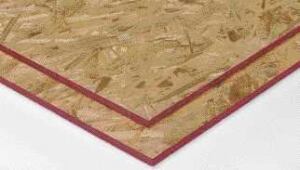

Uplift Panel
For improving moisture resistance, Roy O. Martin’s new WindBrace OSB side-wall panels are specially designed for coastal applications: thanks to their high-resin, southern yellow pine composition, they offer a significant moisture-resistant option over ordinary aspen OSB panels (see Soundings, page 29). In addition, the 7/16-inch-thick sheathing comes in panel lengths each 11/8 inches longer than conventional 8-, 9-, and 10-foot-long panels, so there’s enough meat to tie into the top and bottom plates on standard framing or to lap over the floor framing in multistory construction. In wind zones, this uplift connection will require an aggressive nailing schedule (see “Solving the Uplift Puzzle,” July/August 2007; available at www.coastalcontractor.net). When asked about resistance to nail pull-out, Roy O. Martin stated that these panels shouldn’t be any different than any other sheathing panel. In green-building applications, WindBrace OSB Sidewall can also be ordered as a FSC-certified product, providing assurance about the sustainable origins of the product’s wood content. For more information, contact Roy O. Martin Lumber Management, LLC, 318/448-0405, www.royomartin.com
