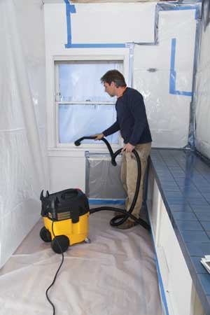

Don’t just slap a HEPA filter into a standard cheap vacuum, Kennel advises, however much you may want to: “The first thing you’ll notice when shopping for HEPA vacs is how much more they cost than the wet/dry models found at most big-box stores,” he points out. “You may be tempted to outfit one of those less-expensive models with an aftermarket HEPA filter—but the machine won’t be EPA-compliant if it wasn’t designed to be used with a HEPA filter … General-purpose vacuums are not well-sealed and retrofit filters may not fit properly in them, which could allow lead dust to escape through gaps in the housing or come blasting out in the exhaust air.”
Note that the RRP Rule doesn’t actually require using a vacuum for cleaning up the jobsite, but if you do use one with power tools for collecting dust from lead-based paint (or untested paint), it has to be a certified HEPA vac. For an overview of requirements, and recommendation for using HEPA vacs on RRP sites, see “The RRP Rule and HEPA Vacs.”
