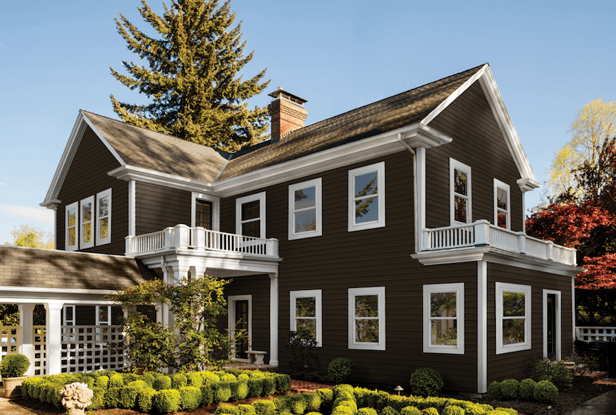

On an exterior, good performance touches aesthetics, savings, and durability.
Alside Trimworks offers profiles that work for replacements as well as additions and new construction.
Alside Trimworks
Alside Trimworks
Designed to save time, labor, and materials, the new Trimworks Decorative Accents are available in three profiles: brickmold, in 1½-inch or ¾-inch sizes; 3½-inch flat casing, available four-sided or with a bullnose sill; and flush mount, for masonry openings. Alside’s SwiftLock technology allows the trims to snap-to-fit. All are available in three extruded vinyl colors and 10 painted colors.

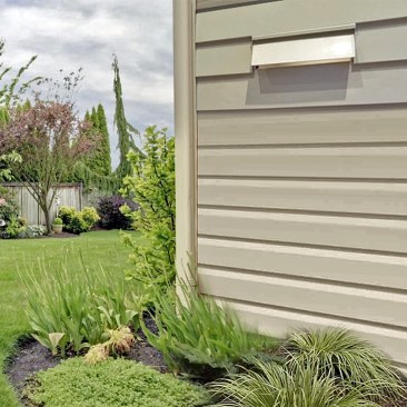

Hide-A-Vent
Hide-A-Vent
The recently patented Hide-A-Vent has been designed to blend into a home’s siding to camouflage exterior vents. Designed by remodeling-contractor-turned-inventor Michael Heinrichs, the customizeable cover can be installed to any section of siding, including clapboard, shingles, and vinyl.
“For years on the job, I have seen countless homes with such beautiful exteriors, but there was always one aspect that stood out—and not in a good way,” explained Heinrichs. “We look forward to seeing the transformation of vents in homes across the country.”
Models come in two sizes: Model A disguises dryer vents and bathroom ceiling fans with a 4-inch round opening, and Model B fits microwave hoods and most residential kitchen hoods with its ¼-inch-by-10¼-inch rectangular opening. Pricing ranges from $40 to $45.

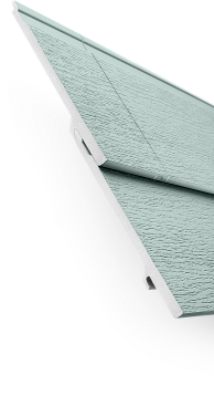

Royal Building Product's Celect cellular siding.
Royal Building Products
Celect Cellular Siding
Royal Building Products has launched a new, unpainted version of its existing Celect cellular composite siding. The Celect Canvas Cellular Siding features the same wood-grain patterns of the finished version, but it may be custom-painted with any exterior vinyl-safe paint shade that falls within the recommended light reflectance (LRV) of 50 or above. (Darker colors may absorb too much heat, which could be detrimental to the long-term performance of the material).
Celect Canvas is now available across all Celect siding profiles, including 7-inch clapboard, board & batten, and 7-inch shake. All Celect Cellular Siding products are low-maintenance, according to the manufacturer, and feature an interlocking seam design made to keep moisture out and virtually eliminate visible seams.

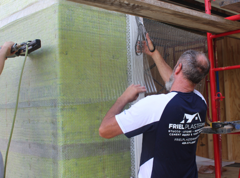

Vented Rainscreen
Amico’s new Hydrodry system combines a series of five components to create a dedicated drainage and ventilation cavity behind veneer stone, masonry siding, and stucco exterior cladding. The system can drain up to 150 gallons of water per hour within the wall cavity, and vent water vapor through the top of the wall at a rate of 0.8 pound per hour, according to independent product analysis. The drain screen, designed for use on the bottom of a wall, features built-in drainage and ventilation slots and accommodates a rainscreen up to 10mm wide.
