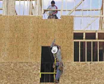

Sheathing for uplift. Engineers working for APA – The Engineered Wood Association, a plywood and OSB industry group, have been pushing what they say is a less costly alternative to metal hardware: full plywood or OSB wall sheathing, carefully applied and heavily nailed in a way that lets the sheathing and nails pick up much of the uplift load. If the sheathing laps over the wall plates at top and bottom, and if the panels are nailed to a framing member or blocking along all panel edges, the sheathing and the nailed connection often have enough strength to resist the uplift loads without any help from hardware. Because coastal homes generally require structural wall sheathing to resist racking, the panel industry argues, it only makes sense to use the plywood or OSB to resist uplift as well, wherever feasible.
Steel still required. In most situations, steel framing hardware will still be required around window and door openings (Figure 3) and at other places where special load paths exist. Shear-wall elements typically still require hold-downs as well. But for many clear wall sections, builders who fully sheathe their walls may be able to skip the hardware (Figure 4). As Louisiana building code consultant and longtime builder Paul LaGrange points out, “It’s easier when you can do something with the sheathing instead of the metal connectors — easier, faster, and cheaper.”

Louisiana’s largest home builder, Southern Homes — one of the state’s few true “production” builders — switched to using Norbord panels in early 2007. Says vice president David Stanton, “Before that, we had U-straps on the bottom and top of the studs, which are now gone. We had header straps on all window and door headers; we’ve eliminated those too. And on the first floor of two-story homes, we’ve eliminated corner hold-downs as well.”
Uniform design. Southern Homes builds primarily in the 110-, 120-, and 130-mph wind-speed zones. Requirements in each zone are slightly different. But the company uses a factory-built panelized wall system and relies on the same two framing-trade contractors to frame houses in all its neighborhoods. So for simplicity’s sake, explains Stanton, “we’ve chosen to build to the 130-mph wind speed in all the communities we build in — whether it’s actually below 110 mph or up to 130 mph — just to keep our framers and our fabricators straight.” Codes require a design professional to specify the wind-resistant details in those high-wind areas. But Stanton notes, “With the Norbord sheathing, we’ve eliminated so much strapping that it’s just not that big a deal on site.”
The key detail is the nailing. “We’re putting nails 3 inches on-center on the edges of the panels and 6 inches on-center in the field,” says Stanton. Wall sections are delivered to the site fully sheathed but with only one piece of the double top plate installed: “So they are sending it out nailed in the first top plate at 3 inches on-center. Then our framer has to apply the second top plate with the proper laps and nail that 3 inches on-center, too.”
Tying in. The wall is not the whole picture, of course — it has to be anchored into the foundation below it and tied to the roof above it. Although Southern Homes’ outside engineer has not required hold-downs, he is calling for closely spaced foundation anchors: “We’re using 5/8- by 10-inch anchor bolts with 3-inch flat washers at 24 inches on-center,” explains Stanton, “plus we need two anchor bolts within the first 8 inches from the wall corner.”
Although wall sheathing can tie upper to lower stories adequately, Southern Homes’ wall-panelizing system doesn’t allow for sheathing to span between stories, notes Stanton: “The walls come out fully sheathed, and then we put our floor truss system between the stories and put sheathing on that.” So to transmit the uplift load between floors, crews still install straps between upper- and lower-story wall studs. “We’re putting straps on every stud across the floors,” says Stanton. And where roof trusses sit on wall plates, every truss is tied down to the wall plate or to a wall stud using a steel connector (Figure 5).
