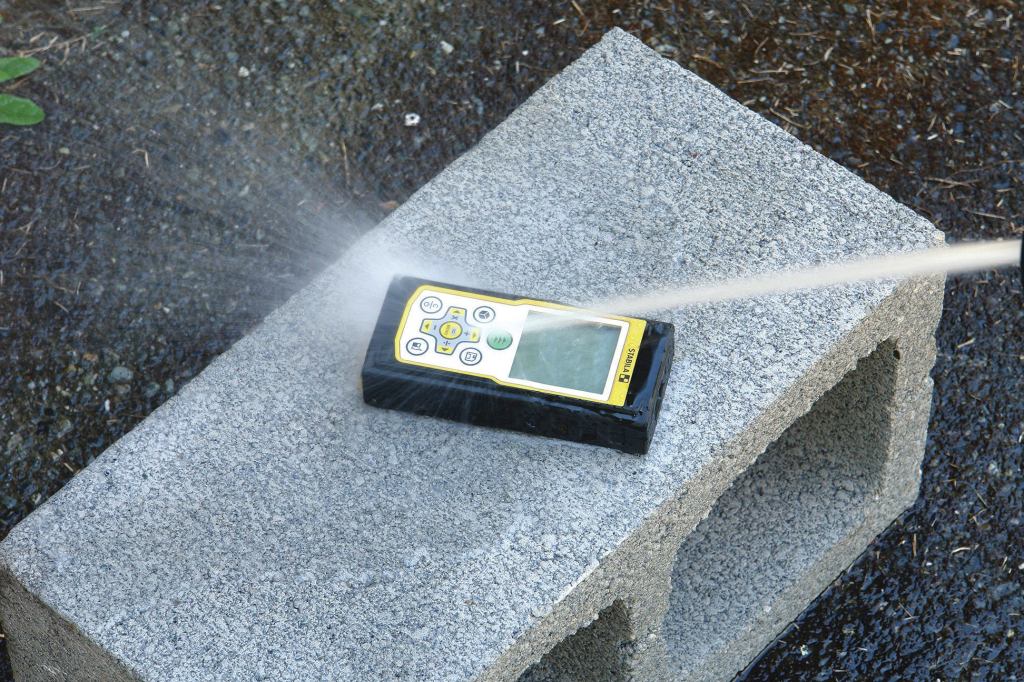

Other common features include a programmable timer that delays the shot after you push the measure button, an illuminated display, and a tailpiece that makes it easy to measure from inside corners to check diagonals. And it has an IP65 rating, which means you can hose it off and it’s completely sealed against dust.
