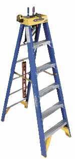

Werner has added a model designed for GCs to its popular Jobstation line of ladders. The Contractor’s Jobstation sports a bucket hook and a large magnet on its molded top for tools and fasteners. But its best feature is the “Tool Lasso,” which can hold any tool with a reasonably sized handle. Three Lassos are included with each ladder; a matching belt hook is sold separately. The 375-pound-capacity Jobstation comes in 6-foot ($140) and 8-foot ($170) sizes.
Werner, 888/523-3370, www.wernerladder.com
