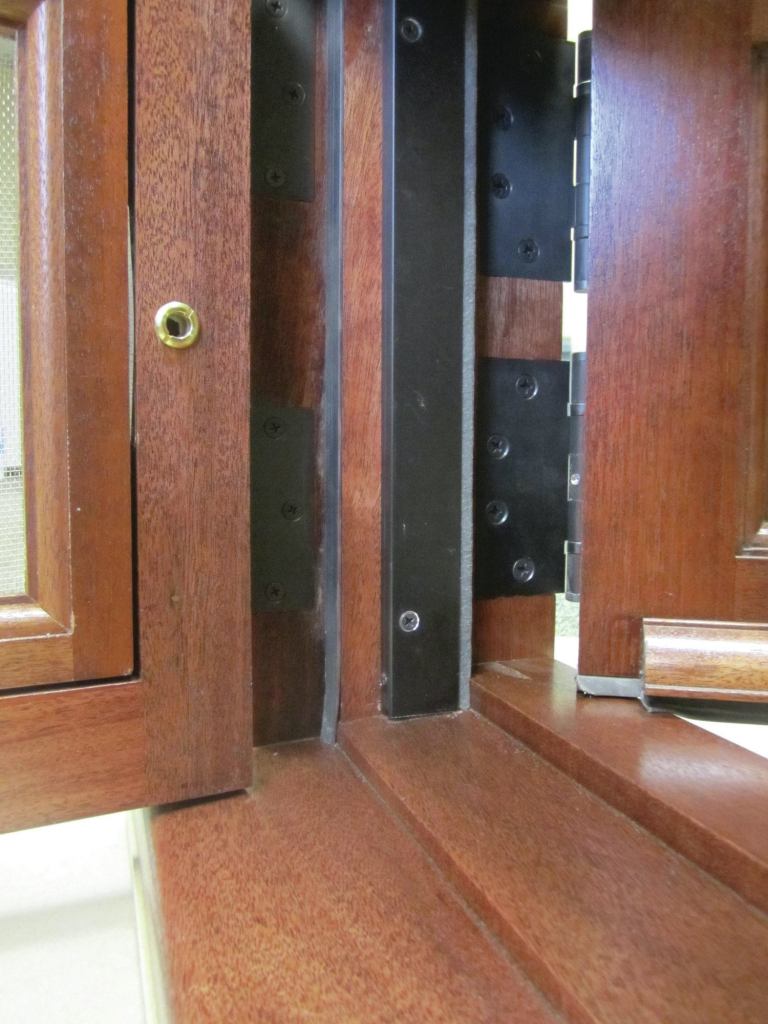

The Coastal Solutions Entry Door is designed to stand up to wind-driven rain, thanks to impact glass and multi-point locking hardware. A stepped wood sill sheds water, with the base of the storm door at the bottom step and that of the main door at the top step. There’s also a weatherstripped drip cap at the base of the main door, and separate jamb weatherstripping for the main and storm doors. Prices start at around $3,500. Upstate Door, 585.786.0341, upstatedoor.com
