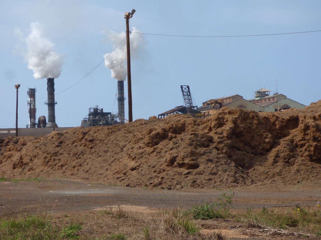

Piles of bagasse on a sugar plantation in Maui
Flickr/Creative Commons License/Forest and Kim Starr

Today, sugarcane is the world’s largest crop in terms of production quantity. Over 120 countries produce nearly 180 million metric tons of sugar, 80% of which is harvested from tropical and subtropical sugarcane. While the focus of production is the plant’s sweet juice, increasing attention is also paid to bagasse. With a name derived from the Spanish word bagazo, originally meaning “rubbish,” bagasse is the residual byproduct of sugarcane stalk processing. Ten tons of sugarcane produce about three tons of bagasse, which is composed of 45% cellulose, 28% hemicellulose, 20% lignin, in addition to other materials. In fact, the composition of bagasse fibers is similar to that of wood, with a high water content, and bagasse is often put to practical use—primarily as a biofuel source to power sugarcane mills.
