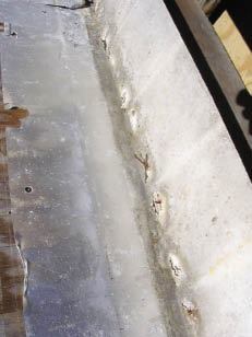

Aluminum has long been the flashing of choice for many builders. It’s inexpensive, widely available, and fairly easy to work with. But when lumber treated with chromated copper arsenate (CCA) was phased out for most residential applications in 2004, aluminum flashing became a lot less attractive for decks (Figure 1).
York Manufacturing
Figure 1. Aluminum has been the go-to flashing for decades, but contact with ACQ and CA preservatives corrodes the metal. And some studies have shown aluminum to corrode too quickly near the coast, even with the less corrosive CCA preservatives of the past.
The two most common replacements for CCA — alkaline copper quaternary (ACQ) and copper azole (CA) — contain two or three times as much copper, in a chemically more active form. When aluminum flashing contacts this copper-laden lumber, the aluminum quickly corrodes. For the majority of decks, which are framed with pressure-treated lumber, aluminum flashing just isn’t an option anymore.
A possible exception to this rule of thumb is the “micronized” versions of these chemical treatments, such as Sustain from PhibroWood (877/737-9663, phibrowood.com) or MicroPro from Osmose (770/233-4200, osmosewood.com). Copper is ground into microscopically tiny particles and the manufacturers say the treated lumber is no more corrosive to aluminum building products than CCA lumber. Even so, some building inspectors may not be receptive to using aluminum flashing with it.
In the experience of Roger Robertson, chief of inspections in Chesterfield County, Va., aluminum flashing had been suspect long before the switch to ACQ and CA lumber treatments. In a local study 15 years ago, inspectors found that aluminum flashing was failing after five to seven years. The county subsequently banned it on decks. Robertson says the change (along with a requirement that rim joists at points of attachment be made of pressure-treated lumber) has sharply reduced the number of reports of rot and, along with it, the need for repairs.

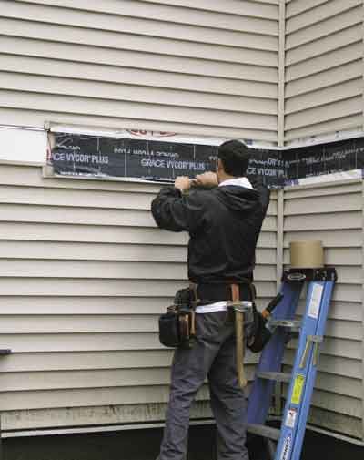

One way around the corrosion problem is to isolate the aluminum from direct contact with framing lumber using a peel-and-stick membrane, like those made by Grace Construction Products (graceconstruction.com) or Protecto Wrap Co. (877/271-9661, protectowrap.com). These rubberized asphalt membranes add another layer of protection and prevent the galvanic corrosion that would otherwise attack the aluminum (Figure 2). On the downside, flashing the ledger then takes two steps instead of one, increasing labor as well as material costs.
Figure 2. Peel-and-stick membranes can be used to isolate metal from wood preservatives, thereby reducing corrosion. When protected from long-term exposure to the sun, they may even be used in place of rigid flashings in some jurisdictions.

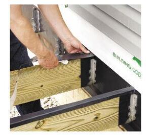

Corrosion-resistant flashing at the ledger is key to preventing water damage to the house. But many builders go further by isolating joist hangers from direct contact with pressure-treated lumber, and by flashing the tops of joists and built-up beams. Where two or more pieces of 2-by material have been nailed together to form a beam, a strip of flashing on top will prevent water from seeping into the joint. Even single-thickness joists may last longer if they’re capped with a strip of flashing before the decking goes down.
Grace promotes its Vycor Deck Protector for exactly this purpose. It consists of very sticky rubberized asphalt protected by a layer of cross-laminated poly and is available in 4-inch-wide rolls made just for joist tops. Wider material can be used to protect the face of the ledger, wrap joist ends where they rest in hangers, or protect the sheathing behind the ledger. Protecto-Wrap makes a similar product called Deck ACQ Flashing Tape, as does MFM Building Products (800/882-7663, deckwrap.com) with its DeckWrap (Figure 6), and JJ Partners with its Joist Jackets (800/700-1179, joistjackets.com). These membranes can be left exposed for up to 30 days but ultimately should be covered. They are not recommended for use in hot desert conditions in the Southwest.
Figure 6. Flashing is not just for the ledger. Particularly in the West, where wood species used for treated lumber don’t absorb preservatives that well, flashing the tops of joists and beams can keep out water and reduce the potential for rot.
PVC, copper, or even strips of tarpaper also might be used to protect the tops of joists. But one advantage of self-adhering membranes is that they seal around fasteners used to attach deck boards or joist hangers. For this reason, Robertson likes the idea of nonmetallic flashing like the Grace or Protecto-Wrap products. “Any time you keep water out of anywhere is a good idea,” he says.
