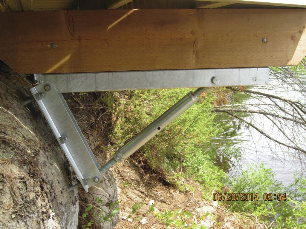

These galvanized steel brackets provide a solid base for a dock, stair landing, or walkway on a rocky shore, with no need for pilings. Once the laser-cut hot-dipped A36-steel-plate bracket bases have been anchored to solid rock with steel studs, the angle of the 36- or 72-inch-long support arms can be adjusted to level. Kits include galvanized mounting hardware and acrylic chemical anchors. The 36-inch bracket ($340 Canadian) adjusts from 25 to 90 degrees; the 72-inch bracket ($540 Canadian), from 40 to 90 degrees. Prices don’t include shipping and taxes. Dock on a Rock, 705.352.0664, dockonarock.wix.com/dockonarock
