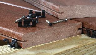

Figure 5. Hidden-fastener clips usually have either prongs that are driven into the side of the deck board (left) or tabs that engage in grooves milled in the side of the decking (right).

Photo credits: Tiger Claw, Fiber Composites. Although I try to upsell every potential client to a hidden fastener system (see Deck Ledger, “Creating Upselling Opportunities,” May/June 2009; free at deckmagazine.com), the additional cost of $4 to $5 per square foot is too much for most clients. The main reason for the extra cost is time. You have to hand-feed two things, the clip and the screw, for each joist. As I write this article, only one hidden fastener system is collated (Figure 6) — the Tebo (Spotnails; 800/873-2239, spotnails.com). When others start to collate, the installation cost will decrease, and they may become more feasible.

While they’re heavily marketed, I’m not sold on pre-grooved hidden fastener systems, even when the job’s budget supports them. First, my engineer advises the use of additional lateral bracing with them, which adds to the framing budget (see sidebar, “Does Decking Add Racking Resistance?”). My second concern is freeze damage. Although I haven’t had a callback for this yet, I worry the grooves will fill with dirt, animal fur, and leaf litter and then hold moisture. Over a 25-year lifespan, a deck may go through hundreds of freeze-thaw cycles. Will grooved decking give me trouble over its life expectancy? If so, I have to depend on my customers to get on their hands and knees to clean out the gaps every year. This is a particular problem in the Pacific Northwest, where we have lots of tree litter.

It would be less of a concern if any of the groove-and-clip systems allowed a larger gap than 1/8 inch to 3/16 inch. I use a 3/8-inch gap, which is probably wider than most builders use, to allow debris to fall through. The common big leaf maple in particular produces seed pods that will not slip through smaller gaps. Kim Katwijk is a deck builder from Olympia, Wash., and a PDB contributing editor. Linda Katwijk is his co-writer.
