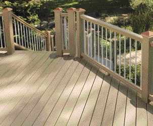

Concealed deck-board fasteners now come in a variety of flavors. It seems that the prong type was the first, followed by tracks, biscuit systems, and, recently, clips that either interlock or fit in grooves cut down the sides of the boards. The newest development is composite decking systems that come grooved for a proprietary clip from the manufacturer. Ipe and other hardwoods may be available locally with similar grooves milled in. As with nearly any product, some users get good results, and others don't. Below are a few things to consider, to make the most of hidden fasteners.

All hidden fastener systems solve one obvious problem, which is that of being exposed. It's more than just an aesthetic issue. The movement of wood or composite decking that's been exposed to the rigors of the outdoors commonly results in nails or screws standing proud of the surface of the board. That's a trip hazard, as well as a minor annoyance to those inclined to take a snow shovel to their deck.

All deck boards move, but in different ways that depend on the material. Wood expands and contracts mostly because of changes in moisture content. Composite decking, on the other hand, expands and contracts with changes in temperature. Deck builders ignore these facts at their own risk.
Wood decking should be installed at a moisture content that's appropriate for the climate. For example, if you install kiln-dried decking in, say, coastal Washington, it's going to expand. It can expand enough across the grain to buckle, no matter what type of fastener you use. Go to a drier area and install wet decking, and you can count on it shrinking. Anecdotally, that can be a particular problem with some biscuit and pronged types of fasteners. In some cases, boards are said to have shrunk enough to disengage from the fasteners. Using lumber that has the correct moisture content for the climate should avoid such problems.
Composite decking that's installed at a high ambient temperature will shrink as the weather cools. Install it in the cold, and it will expand as the temperature rises. Pay attention to the manufacturer's instructions regarding installation in extreme temperatures.
