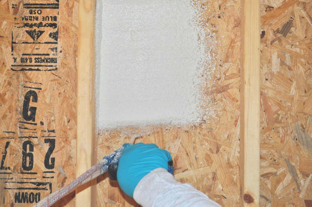

HandiFoam E84 Low GWP spray foam from ICP Building Solutions Group is nonflammable and uses a low global-warming-potential blowing agent. The new formulation reportedly achieves 30% greater adhesion compared with the previous ICP BSG formulation. After application, HandiFoam E84’s color shifts from white to yellow as an indicator of a proper curing profile; the foam achieves a Class 1 fire rating at 2 1/2 inches. The ColorWise nozzle can be converted from a fan spray to a cone spray by snapping off the tip. icpgroup.com
