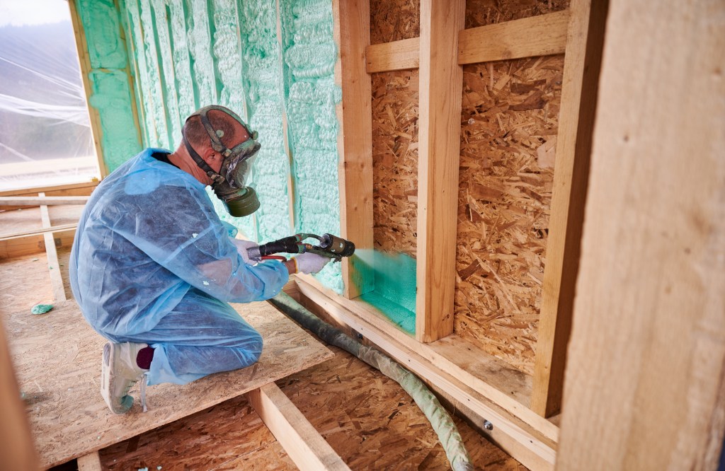

Insulation is the great “split-personality” building material from an environmental perspective. On one hand, insulation’s role in conserving building energy by minimizing thermal transfer is critically important. On the other hand, many typical insulating materials are derived from fossil fuels, require significant power to produce, and incorporate ingredients that are harmful to human health. In such instances, the result is a conflicted material that reduces operational carbon yet increases other environmental hazards. As life cycle accounting methods become more holistic, incorporating all these factors, the benefits of such a material appear to cancel out.
For example, extruded polystyrene, a common insulation material, exhibits a global warming potential of 1,430, which translates to the equivalent of 1,430 tons of CO2 for one ton of emitted gas. A typical spray foam insulation might have a GWP of 700 to 1,000, depending on the blowing agent used. Meanwhile, the material composition of insulation is increasingly under scrutiny. For example, benzene and styrene are fundamental ingredients of expanded polystyrene. Both chemicals, which are released in small amounts during manufacture, are highly toxic. Even an “eco-friendly” foam like polymeric flame retardant has raised concerns with its harmful ingredients of butadiene, styrene, and bromine.
