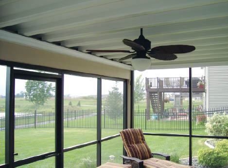

Building a deck creates two distinct spaces. Topside, gleaming deck boards and guardrails invite customers to enjoy the outdoors. But if a deck is far enough above the ground, beneath all the pomp and pizzazz exists another, nearly accidental, outdoor living space. And while its creation may have been unintended, it can be awesome real estate if you trick it out.
Under-deck drainage enables all kinds of upgrades by shielding the area below a deck from rain and snow and diverting the water into a gutter and downspout. All the systems discussed in this article offer a warranty against leaks. Installation methods differ, however, and it’s important to consider how they affect not just the underside of the deck but its entire design.
