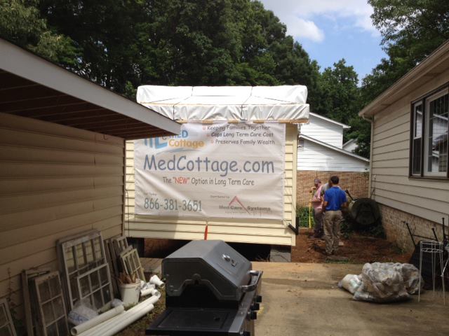

After being craned over the roof of the existing home at right, this medical ADU was fastened to a prepared pier foundation. The two units will later be connected by a deck.

The standard 12x24 MEDCottage unit actually measures a couple of inches less in width, enabling it to be transported easily by truck from one of two manufacturing facilities in Virginia. Once at the site, the unit can be craned onto a prepared pier foundation, avoiding damage to existing fences and landscaping. The basic model currently cost about $85,000, not including delivery and installation. A larger 48' module is also available, which includes space for a live-in caregiver.
