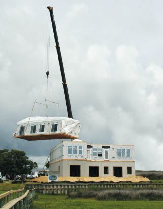

The crane sets a gable roof module as workers on ladders check alignment and make connections.
After the house package is set — a daylong event — carpenters continue work around the outside, nailing off straps and filling in the strips of sheathing that tie the stories together.
