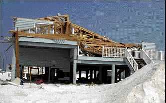

One architecturally designed home that did receive an engineering review prior to construction survived the storm surge from Hurricane Ivan. With the exception of a staircase designed to break away, this Pensacola Beach home remained intact.
As a result, the board decided last year to hire a structural engineer to spot-check plans countywide and consult on those that raised red flags with reviewers. The county also required designers to submit calculations up front showing that their plans satisfied the wind requirements, explains Bill Dumbaugh, Broward's chief structural code compliance officer.
