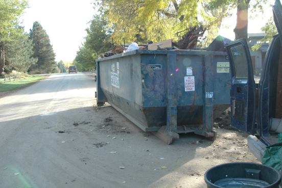

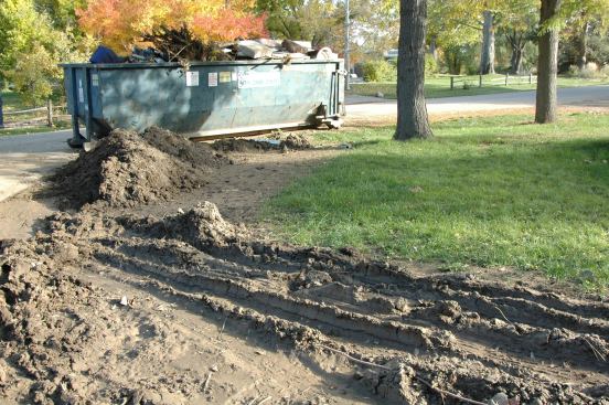

Roll-Off Containers
Roll-off containers were placed in two dozen locations around the city and suburban parts of the county for residents to place flood debris in. It was a good start, but despite containers being hauled off and replaced a couple times a day, the sheer volume of debris being dumped quickly overwhelmed the drop off sites. If a container was full, or if it was too much work to throw sodden materials up and over the side, residents resorted to just dumping their debris on the ground nearby. Pretty soon containers were surrounded by mountains of trash and difficult to get close to.
Despite the strategic difficulties, many of these roll-offs were kept in place for weeks and were removed from sites once the dumping traffic slowed. A handful of these containers have since been reassigned to specifically hard hit neighborhoods in further-out parts of the county.

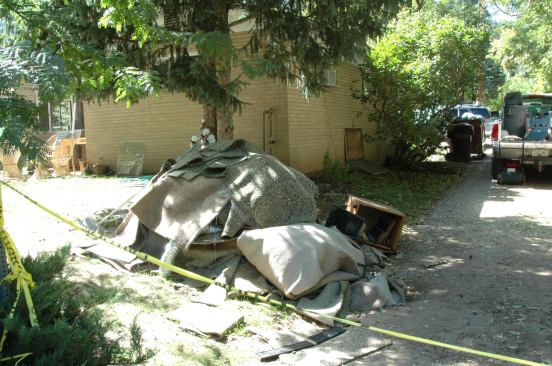

Free Curbside Pickup

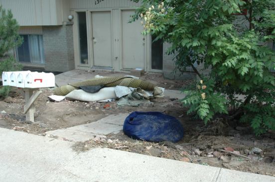

Within the city of Boulder, free curbside pickup was also instituted after it became clear that many residents had no plans to dispose of the thousands of refuse piles that sat in driveways, yards, and alleys for weeks after the flooding. This inaction was exacerbated by the high number of rental units in a college town like Boulder. The landlords didn’t want to pay for private hauling of the tenants’ trash, and the college kids had no motivation to dip into their own pockets for this expense, especially after losing possessions and being displaced from their residences (at least temporarily).
The subsidized pickups went on for about a month which allowed roving grapple trucks to service each house at least twice. The first pickup focused on clearing out the festering garbage while the second one also picked up appliances and piles of flood sediment that residents shoveled out onto the street.
This service was officially limited to residential waste so commercial buildings and multi-family apartments and condos with centralized trash pickup were excluded. And to get your waste picked up for sure, you were supposed to call and register your address with the city by a certain date. If you didn’t, you risked being left out as the trucks finished their work past the funding deadline. Some residents I talked to didn’t call in but received the service anyway. Altogether this program picked up about 5,000 tons of trash, dirt, rocks, and sand from the city’s streets.

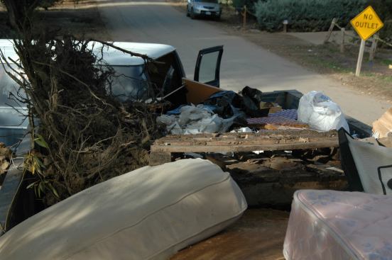

Now that the more densely populated areas of the county have been taken care of, the unincorporated areas of Boulder County are starting to receive cleanup aid. Starting the first week of November, curbside pickup of debris will take place throughout mountain communities in the county. The county is doing things a little bit differently. To save costs and promote recycling and reuse efforts, residents are being asked to separate things into four different piles. General household debris, electronics and appliances, woody debris (vegetation), and mud, silt, sand and rock will all be picked up separately.
After the mountain side of the county is picked up, the plains side may get similar servicing, but that has yet to be decided. For now residents are allowed to haul both flood trash and compostable vegetation debris to the commercial disposal company’s transfer station and drop it free of charge. Currently, a bigger priority for county waste resources is to remove the piles of debris from waterways and under bridges that could present a hazard the next time the water rises.

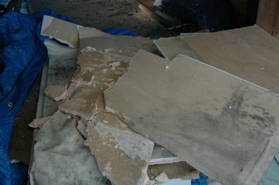

For those without machinery (or at least a tall truck), using these sites isn’t really worth the trouble anyway. When I hauled wet drywall and tiled wall sections out to one of the roll-offs, it proved to be quite a chore to lift everything up and over its seven-foot tall sides. And if the debris I was hauling was dripping with contaminated muck, I wouldn’t have wanted to lift it over my head even I could.
