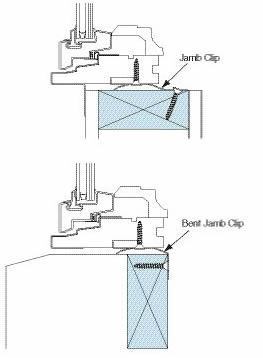

Installation
Storm-resistant windows must be installed so that they transfer the stress of impact and pressure cycling to the rough framing around the window, lessening the forces acting on the window frame and hardware. Otherwise, the force would be more likely to break the glass or blow the sash out of the window. In the highest wind zones, installers have to drive screws through the window jamb into the rough framing. For other zones, some manufacturers supply clips that the installer has to screw into the jamb and the rough frame. The clip takes the force and transfers it to the frame. “It reminds me of a commercial building in the city, with high wind loads,” says Ron Ferrarri of Lion’s Head Builders in Easthampton, N.Y. “You have to do it right to keep the warranty, but as far as I’m concerned, it’s just the right way to do it. Once your team learns how, it doesn’t add that much time to the job.”
Other builders we spoke with agree. Andy DiGiammo runs Master Builder Construction in Freetown, Mass. Although his state hasn’t adopted the IRC yet, he used Andersen’s Stormwatch product on a house in Westport, Mass. He says that the installation wasn’t that different. The biggest differences were that the windows are a bit heavier than standard ones, and you have to put a nail in every hole in the nailing fin, plus surround the window with a self-adhesive water barrier.
