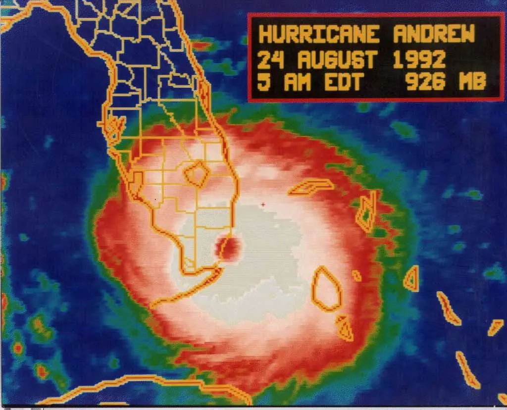

Twenty Years Later, Florida Looks Back at Hurricane Andrew
NOAA
August 24th marked the 20th anniversary of the date that Hurricane Andrew made landfall on South Florida’s Atlantic coast. The storm destroyed more than 65,000 structures; the aftermath would change the building industry in Florida, and indeed along the entire U.S. Atlantic and Gulf of Mexico coastlines.
Andrew “left a 25-mile-wide arc of battered homes, flooded streets and felled trees and power lines across the southern tip of Florida when it struck on Aug. 24, 1992, ripping away the state’s pretenses of safety along with much of Miami-Dade’s infrastructure,” writes Jonathan Simmons on TCPalm.com (“Hurricane Andrew 20 years later: Everything changed,” by Jonathan Simmons). “That storm, officials said, changed everything: from how homes are designed to how meteorologists track hurricanes and how the government manages emergencies.”
