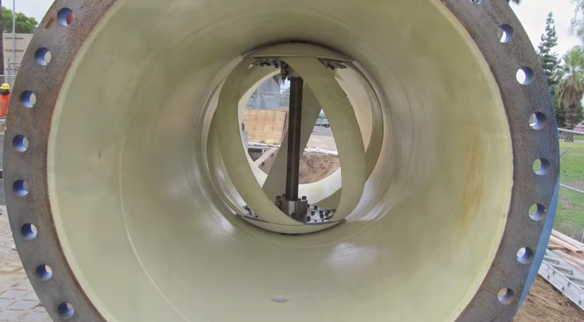

It’s a simple concept, and one of those “why didn’t I think of that” for folks all around the globe: As water flows through city water pipes, embedded turbines spin, powering attached generators, which then feed energy back into the city’s electrical grid.
This aptly describes phase one of a project in Portland, OR, where the city water department has replaced a section of its existing water main with Lucid Energy pipes containing four 42-inch turbines. Known as the “Conduit 3 Hydroelectric Project,” Portland’s new clean energy source is expected to be up and running at full capacity this month.
