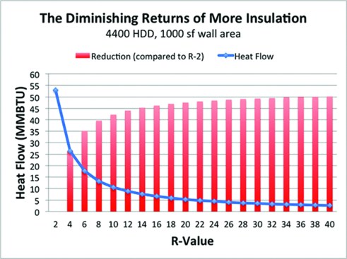

Each red bar represents an additional R-2 of insulation. As insulation levels increase, the reduction in heat flow levels out. Chart courtesy of Energy Vanguard
At its discussion of the thermal layer, PGH delivers a pair of key lessons on the wise use of dollars for 21st century home construction. First, a graph illustrates the rapidly diminishing effectiveness of wall insulation beyond R-20 (see original graph from Allison Bailes, above). And that suggests there may at times be better ways to budget your money than building double stud walls or Larsen trusses with ultra-thick insulation. Second, the authors underscore the fact that a quarter of a typical home’s heat escapes through the cracks and seams in the building envelope. Preventing those leaks, they remind us, is the most cost-effective way of reducing loss of conditioned air.
