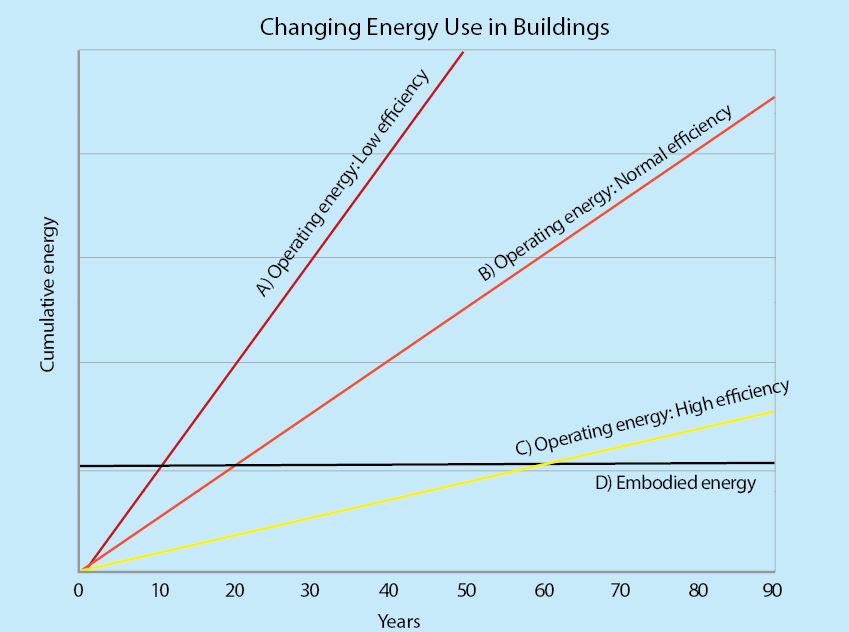

As buildings become more efficient, the amount of energy needed to operate them falls. The more efficient buildings become, the more operational energy approaches the energy embodied in the manufacturing of the building materials. Energy is often seen as a proxy for carbon emissions—a comparison that is fairly accurate when the majority of energy comes from fossil fuels. As more energy is decarbonized (generated from non-fossil-fuel sources), the reduction of operational carbon will accelerate, and embodied carbon will become the dominant source of carbon emissions from buildings. This is what Canadian architect and educator Lloyd Alter calls “the ironclad rule of carbon.” (Chart data by John Ochsendorf/MIT)

So why do we care about stored carbon? For years, buildings were leaky and energy was dirty, resulting in massive amounts of CO₂ being released into the atmosphere to heat, cool, and operate them. As we tighten up and insulate the building envelope, and heat, cool, and run buildings with clean, renewable energy (decarbonized energy), the amount of operational energy gets much smaller relative to the upfront, or embodied, energy, which becomes significantly more important (see chart, above).
