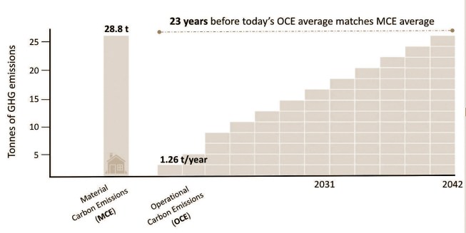

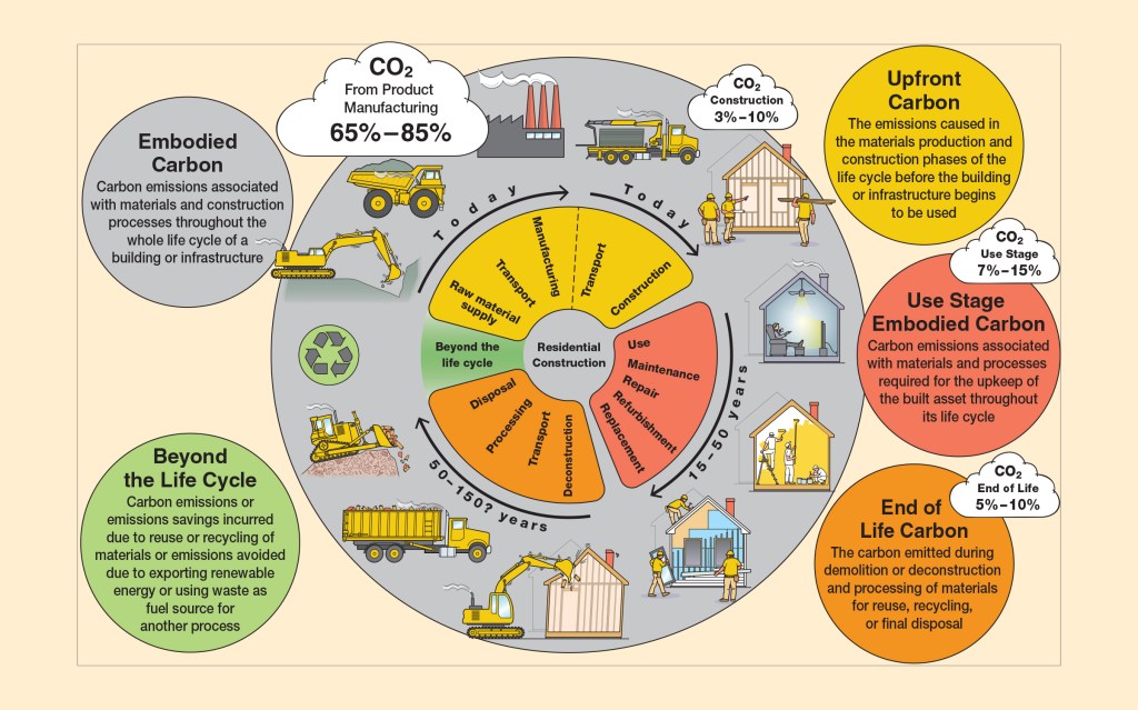

Now, however, there’s a growing awareness of reducing a second—many believe, more critical—type of CO₂ emissions known as “embodied carbon” or “upfront carbon,” which consists of the total CO₂ emitted when we extract, manufacture, transport, and install all the materials that go into our buildings. (See “Carbon and the Carbon Cycle.”)
What is eye-opening to those of us who have struggled to squeeze out every extra Btu through energy-efficient construction (as with Passive Houses, for example) is that the amount of embodied carbon in a new building is huge. In fact, the quantity of upfront carbon released into the atmosphere to construct even a zero-energy home can equate to decades of the CO₂ emitted (operational carbon) by using that house. Builders striving to make a large and immediate reduction to CO₂ going into earth’s atmosphere must find ways to lower the amount of embodied carbon going into their buildings. Looked at another way, construction material emissions are “today” emissions; they are released into the atmosphere even before the building is built. If our goal is to reduce emissions now, these are the emissions we must focus on.
A study prepared by Builders for Climate Action examining the carbon emissions from homes built in two Canadian cities showed that it would take 23 years for the operational carbon emissions to reach the level of material carbon emitted during construction.

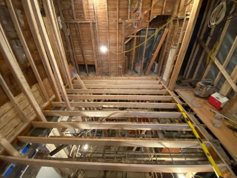

Use existing infrastructure to lower embodied carbon. When it comes to building with low embodied carbon, the best thing you can do is reuse a building or its parts. It may not be cheaper, but whole-building renovation and reuse have been calculated to save up to 75% of embodied carbon emissions compared with constructing a new building. This is because most embodied carbon resides in the foundation and the structure—especially if they are concrete and steel. By retaining those, that carbon is already accounted for.
A view of the new framing, including new joist that tie into the new rim joist at left.
Michael Anschel
Whole-building renovation and reuse can save up to 75% of embodied carbon emissions compared with constructing a new building.
If you cannot reuse the whole building, look to salvage and reuse its materials—brick, metals, broken concrete, and wood. Reclaimed materials, in general, have a much lower embodied-carbon footprint than new materials because the carbon to manufacture them has already been spent. Even the additional carbon impact of salvaging materials and making them fit for reuse is often lower than manufacturing new materials.

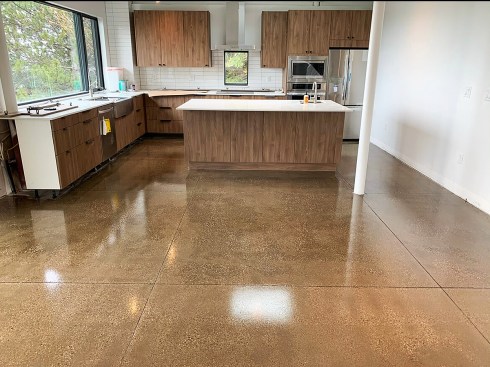

If a house is built on a structural slab, consider finishing the slab surface to avoid introducing yet more materials into the home. (Photo courtesy Hard Rock Concrete Coatings)

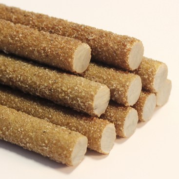

Using materials made from what today is considered “agricultural waste”—products such as wheat or rice stalks that are commonly burned—can make a big impact on a project’s carbon footprint because they sequester carbon that would otherwise go into the atmosphere as methane when they’re allowed to rot, or as CO₂ when burned to make electricity. Wood may be the first material to come to mind, but other options include straw or hemp-based materials, say for insulation, which—unlike wood—not only store carbon but are annually renewable. And cellulose insulation, which has been successfully used for decades, is a no-brainer choice, with its negative carbon footprint.

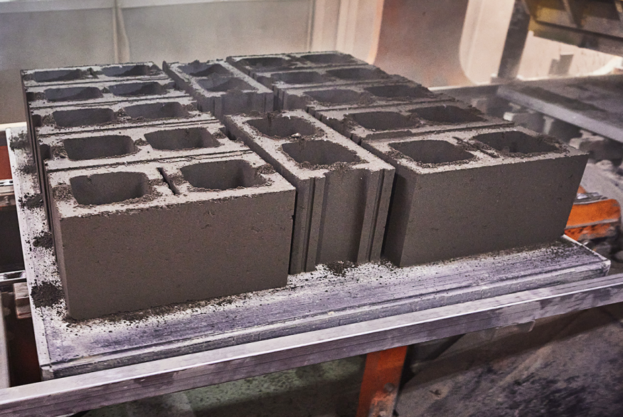

Montreal-based Carbicrete has developed a process for producing structural concrete products with steel slag instead of with carbon-intensive cement.
Newer substitutes such as hempcrete and carbon-neutral CMU block can work in many applications. Carbicrete of Montreal, with funding from the Quebec government, has developed a method of making concrete without cement by replacing it with a by-product of steel production, steel slag.

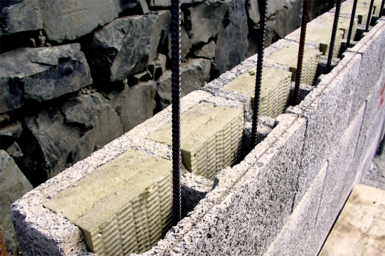

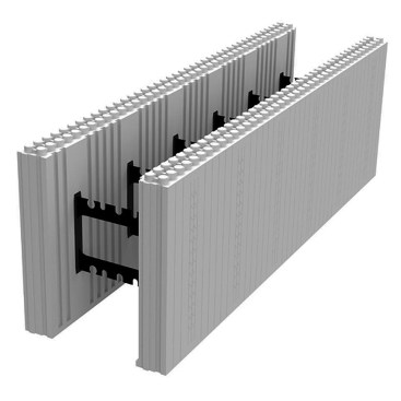

Insulated concrete forms (ICFs). For those builders who do not want to abandon the many positive benefits of ICFs, fiberglass rebar and fly-ash-enhanced cement can reduce the carbon content in what is a relatively high-embodied-carbon building-envelope system. ICFs such as Logix Platinum Series, which uses BASF Neopor low-carbon-content foam, can also reduce a project’s carbon footprint. And concrete form blocks, such as Nexcem, made with wood chips or other natural fibrous materials, eliminate high-carbon foam while offering a comparable resilient, energy-efficient building system.
Insulated concrete form (ICF) blocks inherently make efficient use of concrete. The ICFs from Logix shown here are made with a low-carbon foam developed by BASF.
The ICFs from Logix are made with a low-carbon foam developed by BASF.
ICFs from Nexcem are made with cement-bonded wood waste. The ones shown here are filled with Rockwool insulation inserts.
Insulated concrete form (ICF) blocks inherently make efficient use of concrete. ICFs from Nexcem are made with cement-bonded wood waste. These include Rockwool inserts.

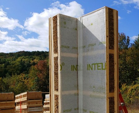

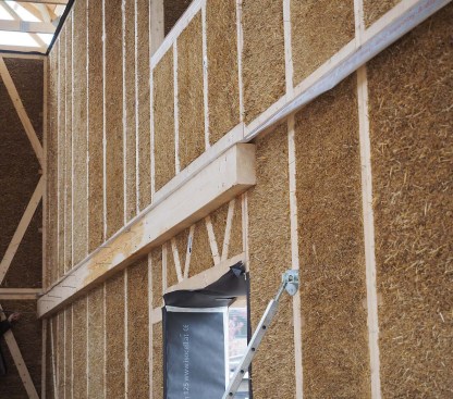

Straw combined with other low-carbon insulation and vapor control layers is increasingly chosen as the base for structural frame panels, using both site-built panels (see New Frameworks example, below) and commercially available panels. Straw Bale SIP Walls by NatureBuilt, which have 1-inch-thick cement- and lime-plaster skins and straw filler between, and EcoCocon (see below) are two available panels.
New Frameworks, a building company in Burlington, Vt., makes their own structural straw panels, which incorporate a continuous layer of Gutex insulation on the exterior and an Intello vapor barrier on the interior (both available in the U.S. from 475).
EcoCocon, a structural wall system offered to the U.S. market by Build With Nature, uses 15 3/4-inch-wide timber-straw panels with an R-value of 38.3.

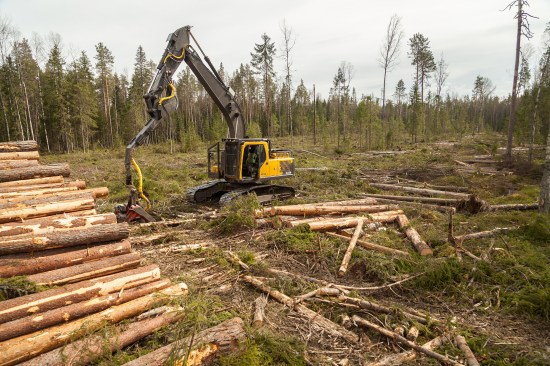

Wood framing. If you traditionally frame using 2×4, 2×6, or larger stud- or timber-framed walls, you are already on a path to a lower-carbon-footprint building. “Wood is good” because the material takes significantly less processing energy to extract, transport, and process (mill and kiln dry). And the carbon in the lumber, cladding, flooring, and so on is stored (sequestered) until the wood burns or decays—which returns the carbon to the atmosphere. However, the complete carbon cycle isn’t as clear as it looks, since there are consequences to removing trees that could still be capturing carbon if left in the forest, and it’s not clear how the roots of cut trees and branches and slash contribute to atmospheric carbon.
Compared to many other building materials, harvesting and milling framing lumber releases relatively little carbon. But most lumber also requires removing trees that could still be capturing carbon if left in the forest. In addition, leaving the roots and branches of cut trees to rot in the forest contributes to atmospheric carbon. The combined impacts make wood a less than optimal material for lowering a building's carbon footprint.
Compared with many other building materials, harvesting and milling framing lumber releases relatively little carbon. But most lumber also requires removing trees that could still be capturing carbon if left in the forest. In addition, leaving the roots and branches of cut trees to rot in the forest contributes to atmospheric carbon. The combined impacts make wood a less than optimal material for lowering a building's carbon footprint.
Of course, you can simply use less wood by using advanced “optimum value engineering” (OVE, also commonly called “advanced framing”): 24-inch-on-center stud spacing, single top plates, box headers, and other wood- (read: carbon- and money-) saving tactics.

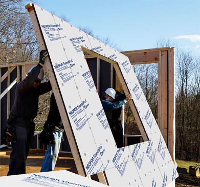

Neopor rigid foam panels from BASF offer a low-carbon alternative for continuous exterior insulation.

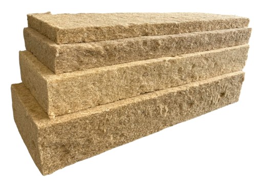

Among the growing list of hemp-based building materials, Nature Fibre's  insulation comes in 2- to 7 1/2-inch-thick batts.
At R-5 per inch, Neopor rigid foam panels (shown at left) offer a low-carbon alternative for continuous exterior insulation . Among the growing list of hemp-based building materials, Nature Fibre's insulation (above) comes in 2- to 7 1/2-inch-thick batts (R-3.7 per in.).

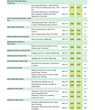

There is a marked difference between glass-fiber materials or petrochemical-based materials, such as closed-cell spray polyurethane foam at 409 kg CO₂ net emissions, and bio-based products that store carbon. Some bio-based materials can contain more atmospheric carbon in the physical substance (that gets stored and therefore not emitted to the atmosphere) than was emitted in producing the material. For instance, cellulose is carbon negative at -66 kg CO₂; hempcrete at -187 kg CO₂; and straw bale with a whopping -238 kg CO₂ net emissions.
Click to enlarge
A BEAM calculation of the embodied carbon in insulation materials reveals a wide range of variability, from a high of +409 with carbon-intensive closed-cell spray foam to a low of -238 with carbon-sequestering straw bales.

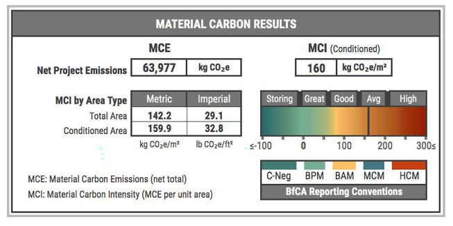

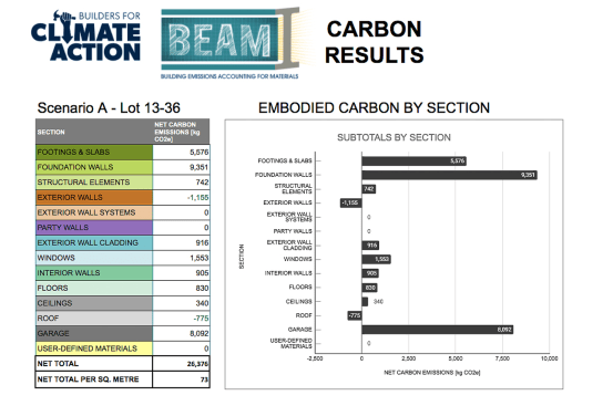

BEAM Carbon Calculator
As mentioned earlier, there are several software tools available to help designers and builders calculate the amount of embodied carbon in the materials, assemblies, and buildings they build. But as a builder who wants to spend time building, I want a tool that I can use out of the box without a large learning curve. BEAM, which stands for Building Emissions Accounting for Materials, is a user-friendly, climate-science- and methodology-based software tool, built by a team at Builders for Climate Action.
You can get a free copy or make a donation to the Builders for Climate Action website (buildersforclimateaction.org/beam-estimator) and log in to use the BEAM Estimator. The tool is a sophisticated Google Docs online spreadsheet that is, relative to other calculating tools, simple to use, especially for builders because it’s based on 12 construction categories: footings and slabs, foundation walls, structural elements, and so on up to the roof.

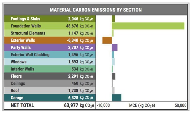

With BEAM, you can compare embodied carbon in materials, such as different types of insulation (see screenshot of chart, above); you can build assemblies and compare them (see sample at left, top); and you can compare whole buildings built with different materials (see sample of results, below).
With BEAM, you can compare the material carbon embodied in different building assemblies for a project (top) and see the results  for the whole building (above).
BEAM has a concise user guide to help you get started and comes preloaded with all the residential EPD data the creators could locate, and they continue to add more as it becomes available, which is a good reason to donate. You can toggle between metric and imperial measurements, a huge relief for U.S. builders unfamiliar with metric measurements like kilogram per square meter.
You will need to have a good understanding of building design and construction to navigate the assembly sections and make appropriate selections. Within each assembly section are categories of materials that will be appropriate for your project and likely many that will not be. It is up to you to build assemblies that are feasible and meet all the energy-performance and legal requirements for your project. BEAM doesn’t provide any warnings or suggestions about appropriate selections.
It’s worth noting that BEAM Estimator is a work in progress; nevertheless, the results are the best results possible given the current state of Life Cycle Analysis. Data in EPDs and the resulting outcomes are not 100% accurate numbers, so users should view them as guides to their selections of low-carbon materials. But as the authors make clear, especially for the three largest carbon-footprint categories of materials, reducing material amounts or making lower upfront carbon substitutions is more important than a few percentage points of error. Saving carbon now is much more critical than saving carbon over the next 30 years.
