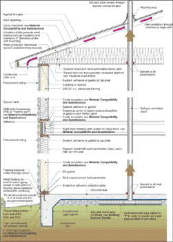

• Compact fluorescent lights in high-traffic areas Centex touts studies indicating that its new “Energy Advantage” houses are 22% better performing than a new house built to the 2006 International Energy Efficiency Code, and as much as 40% better than a typical ten-year-old house. And while most of these items could be added to an existing house, doing so would not be free. So the latest Centex models represent a serious challenge to any other builder in the Charleston-area market. On the other hand, energy-efficient construction methods are not some kind of trade secret — Building America, the Energy-Efficient Builders Association ( www.eeba.org), and many other groups are devoted to spreading the word. So any builder who’s willing to make the effort should be able to match, or even top, Centex’s results. For information on high-performance houses in a wide range of climates, one good information source is the website of Building Science, Inc., at www.buildingscience.com. The Building Science team has published a set of high-performance design concept examples on this ” Designs that Work” page. Any of the examples in the Mixed-Humid or Hot-Humid sets would be instructive for a builder in Low Country South Carolina. Click for larger version
Energy-efficient details for Mixed- and Hot-Humid climates can be found in the “Designs that Work” pages on buildingscience.com
