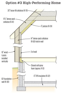

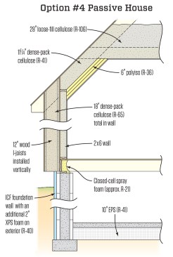

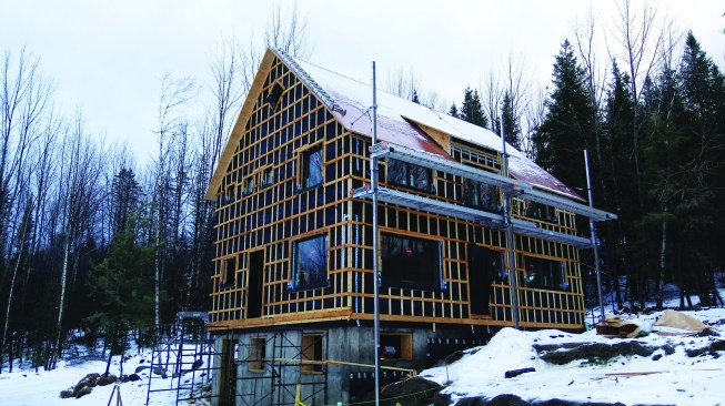

In this example, the homeowners chose a superinsulated wall system with an exterior insulation curtain composed of 10-inch wood I-joists filled with dense-blown cellulose insulation.

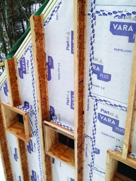

A smart vapor and air control membrane was located in the center of the wall between the interior stud frame and the exterior I-joist build-out.

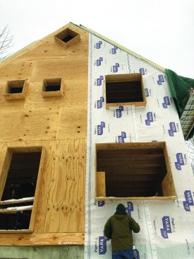

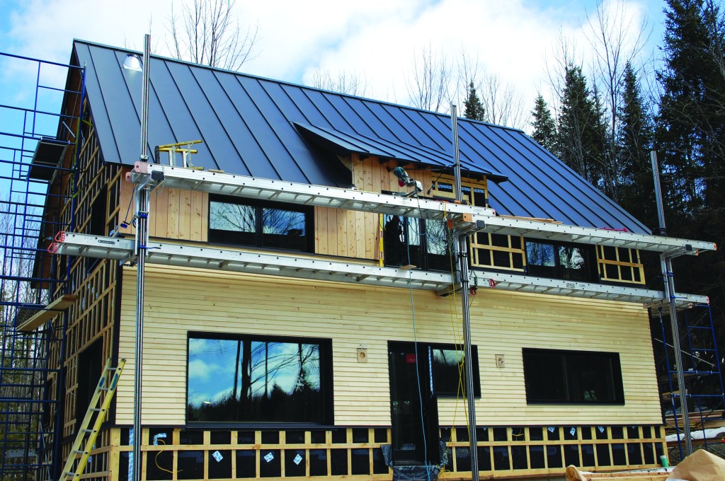

The homeowners chose a rainscreen siding system requiring a drainage-plane membrane and cross-strapping, which resulted in a significant increase in cost compared with the next-lower-performing option.

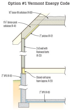

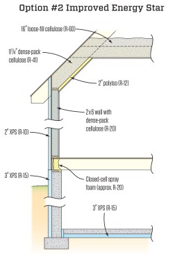

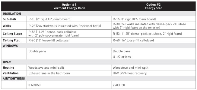

I use four benchmark levels of efficiency for my comparison modeling: the Vermont Residential Building Energy Code, Energy Star (with some upgrades to meet Efficiency Vermont’s Base Level Certified Home), Efficiency Vermont’s High Performing Certified Home, and Passive House Institute US Certified Passive House. These four levels make sense for my area but could differ by region. The efficiency specs and how I planned on satisfying them for this project are presented in the tables on the following pages.
By the way, the Vermont energy code offers five “packages” or combinations of different insulation levels for compliance. I chose Package #4 to model, because it seemed the most cost-effective option for this house design.

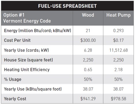

While kBtu/square foot/year is useful during energy modeling, it doesn’t necessarily mean that much to the average homeowner. The real goal is to be able to tell the homeowner about how much their house will cost to heat or cool. To do that, I take the kBtu/square foot/year data and input it into a spreadsheet that gives me the cost per year to heat based on the type of fuel used (see Fuel Use Spreadsheet, above). The approach for the heating system on this project was to use a woodstove and mini-split heat pump combination. The example above is for Option #1 Vermont Energy Code, which, given a 50%/50% split between wood heat and mini-split heat, was estimated to cost about $1,919 per year for heat. For each level of efficiency, I convert kBtu/square foot/year to yearly heating costs.

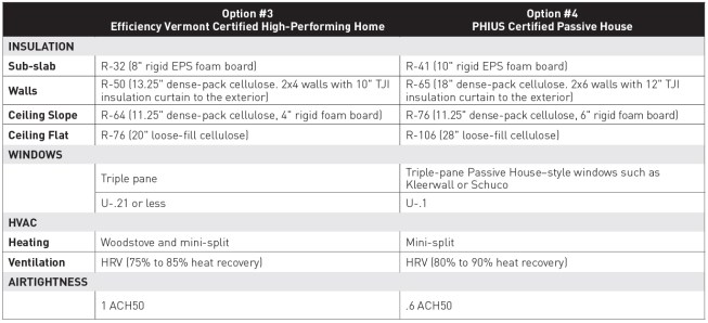

Each level of efficiency will involve different wall assemblies, different size heating systems, a different ventilation approach, and different windows, each with different labor and material costs. On this project, Options #1 and #2 were similar, while Options #3 and #4 had big differences. To achieve the Passive House heating demand, Option #4 required more windows on the south and more insulation, which meant a different wall construction.
With regard to airtightness, Option #1 required the least effort and cost. For Option #2, reaching 2 ACH50 would be easily accomplished by taping the seams of the rigid-foam insulation layer. General air-sealing would be done in the attic prior to installing loose-fill cellulose. Options #3 and #4 required labor-intensive Passive House air-sealing techniques. Sticking to not more than four options will limit the amount of time you spend on estimating. Some homeowners will want to explore every option available, but for this process, four is more than enough. The final building assembly and price can be fine-tuned later.

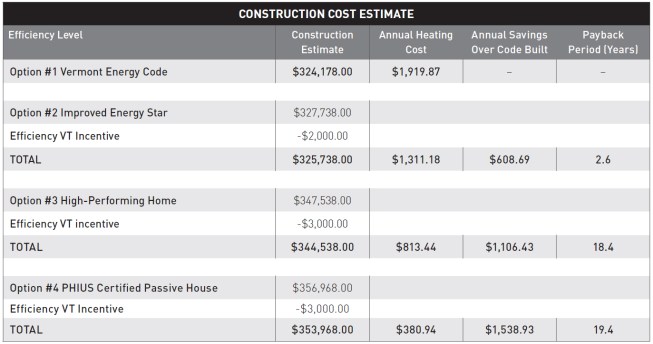

The final step is combining the construction cost estimates and heating cost estimates to calculate payback periods. I use a spreadsheet for this (see facing page). I don’t attempt to account for energy cost inflation because energy prices move up and down seasonally and year to year.
For this example, the largest jump in cost was from Option #2 (the Energy Star Home) to Option #3 (the High-Performing Home). For the homeowners to be willing to make this jump, they would have to plan on living in the house for a while—almost 20 years—before seeing a return on their initial efficiency investment. After that point, however, the savings start to add up quickly. The reasons for this jump in cost for this particular house were threefold: the cost of upgrading to triple-pane windows (about $7,000), the cost of the added insulation (about $8,000), and the cost of the additional frame needed to hold the insulation (another $8,000). The ratio of dollars spent on upgrades to dollars saved changes drastically at the High-Performing level because of these big-ticket upgrades.

These homeowners were willing to make the jump. The biggest factor is always the budget, and for this project, we were able to provide Option #3 within their budget. Because they plan on living in this house far into the future, a payback period of 20 years was worth it for them. The additional comfort this option provided was a bonus.
Going a step further to Passive House at first seemed to make sense based on this analysis, but the devil was in the details. In order to keep the Passive House budget close to the High-Performing Home budget, a few compromises had to be made in the construction cost estimating. The woodstove wasn’t needed and therefore was eliminated; we had to switch from domestic-wood-interior/clad-exterior windows to European uPVC windows with limited color options; and the design needed to be altered for more solar gain. With the woodstove and comparable-looking Passive House windows added to the Option #4 budget, Passive House was out of reach. The payback period without these compromises would be 32 years. Passive House performance ultimately involved too many compromises for these homeowners, and they decided to stick with Option #3, the High-Performing Home.
