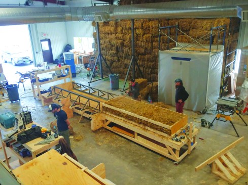

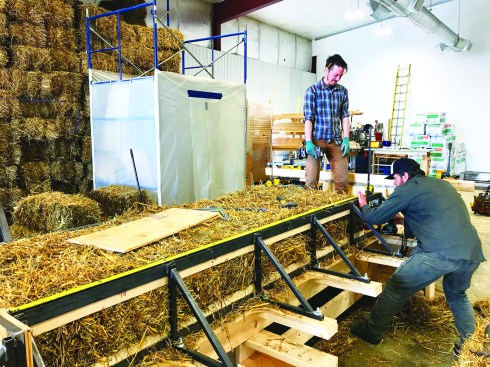

In the shop, panels are assembled in a steel frame and packed with straw bales.
New Frameworks also learned from the work of Chris Magwood and his Ontario, Canada-based organization, the Endeavour Centre. Magwood, author of Essential Pre-Fab Straw Bale Construction, The Complete Step-by-Step Guide, brought New Frameworks some essential methods gleaned from a Canadian straw-bale-panel company started by one of his Endeavour Centre students. Armed with that knowledge, New Frameworks invested in basic equipment and started to build panels.
Jackson Mills, project lead for the Leyden house, explains the process. “It started with individual cut sheets for each panel from the design office,” he says, “so every panel had its own design page. And we precut all the lumber and sheathing, and we had two assembly tables. One of those tables had a machined template, a kind of little cage that we built the frame inside of, to make sure that there was as little variation as possible. When we built the frame inside of that, it made sure that the frame was exact. After we built the frame, we installed the bales. Then we pulled out that panel [and moved it] onto the second assembly table. We trimmed the straw to make sure that it was exactly flush with the framing, and then installed the sheathing; and on the same table on top of the sheathing, we installed the Gutex fiberboard (we used Gutex Multitherm 60). And then it was strapping for the rainscreen on top of that, corner protection, and then we flipped it, shaved the bales down again flush with the framing, and then attached the Intello, which we used as the air barrier. And then corner protection on top of that.”

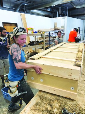

The panels are moved onto another work table for installation of Gutex insulation and Intello vapor barrier.
Including the Gutex fiberboard, each panel weighed about 500 pounds, says Mills. In the shop, the crew was able to roll the panels around on the assembly tables, and move and stack them using a rented forklift. On site, the crew set the panels using a telehandler.

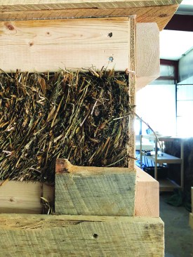

Panels have a clear-wall R-value of about R-40, says Mills. To create a continuous air and vapor control layer, the crew taped the Intello smart vapor retarder on the inside face of each panel to the adjacent panel on site when they set it. On the outboard face of the panels, the Gutex fiberboard forms the building’s drainage plane, and strapping outboard of that creates the air space for a rainscreen siding application.

This panel has Gutex fiberboard insulation, rainscreen strapping, and corner protection applied. Above, a closeup of the panel in cross section.

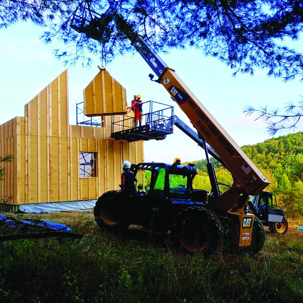

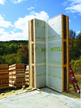

Panels are set on site using telehandler forklifts. Above, a corner has been assembled from two panels on site.
Wiring on the inside of the house runs in a service cavity built with 2x2s, says Mills. Penetrations, where needed, are cut with a hole saw. “We entertained the idea of pre-installing conduit for all penetrations, but that would really require knowing down to the inch where the plumber or electrician or whoever was going to put the penetrations, so we decided against doing it ahead of time,” says Mills. “But when they do have the penetrations mapped out, they’ll hole-saw it and install the conduit, and gasket and tape to the Intello on the interior, and prime and flash tape to the Gutex on the exterior.”

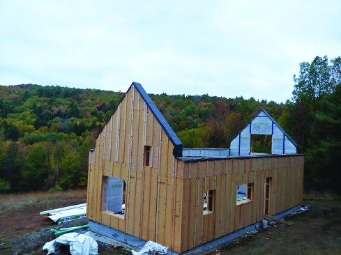

One challenge on site, says Mills, is the need for a dead-level sill plate. “We built the panels to such exacting standards that the transitions and connections between them are really tight,” he says, “so if your sill plate is out of level, then the connections won’t be tight. They would be off kilter to each other. It’s a double sill plate, meaning one to the interior and one to the exterior, because of the thickness of the wall. And they have to be level in both directions. We had to do some work to level the sills.”
The completed walls of the house sit ready for roof trusses
